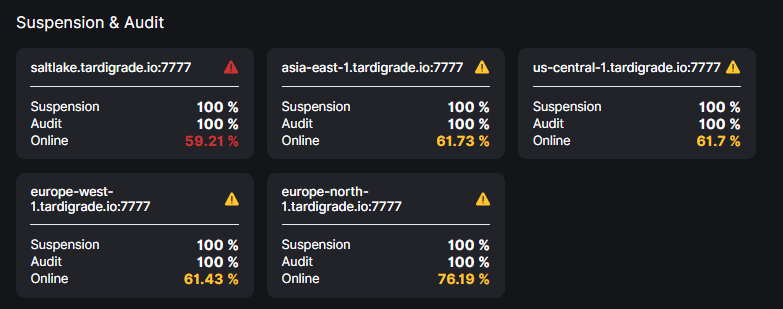

It seems everything is back on track! As i stated before, it was an infortune i had with my node, and i was so frustrated that i lost my key and needed to do a clean windows install i didn’t reinstalled the node until now.
It seems that the node is going back on track.
Here are my stats at the moment:
And here:
Will keep in mind your explanation and any change i do to the node i will ask here so i wont get in trouble in the future.
Ahh good to see it’s recovering. As you can see most data has been moved to trash like I predicted. You may see that for a bit. Garbage collection happens in a few phases, but the bottom line is it will eventually clean up all trash and your node will be in great condition, but just with less data stored. That’ll fill up again over time though.
