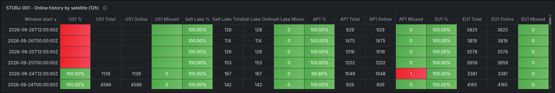

The previous topic about audit for US satellite was closed. For my nodes, I stop receiving audit since 21 Jul.
“windowStart”****: “2026-07-20T00:00:00Z”,
“totalCount”****: 4**,**
“onlineCount”****: 4
this is the last record I have from the api sno.

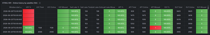

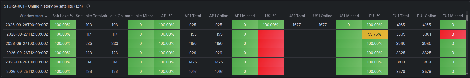

yes. worked for a few days, but now it has stopped again.
Here are many threads concerning weird behaviour of especially the US1 sattelite. Looks like the guys are still working on its migration, some day it’ll be back to normal operation ![]()
I can confirm the same behaviour on all of my nodes.
The team is aware of this issue too. No ETA yet.
It should be fixed soon ™.
The final stage of the migration is complete and audits from US1 have resumed.
However, the online score instability remains unresolved: Dropping online status.
Thank you for the update. I can confirm that US1 audits have resumed on all of my nodes.
yes, its auditing again / still auditing ![]()
only way slower than before, but as long as its working should be fine
