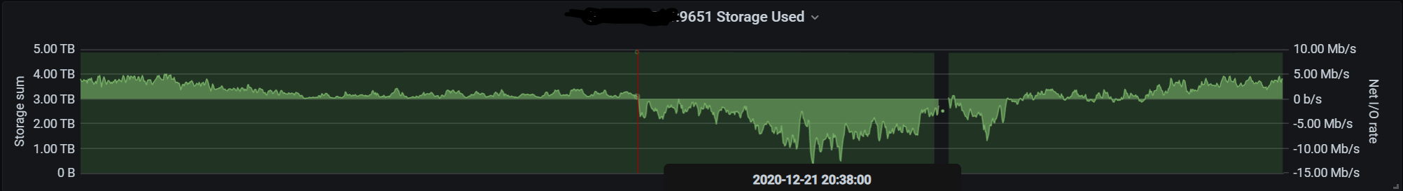

Things did kinda slow down over the past two days:
Yea, things were going great(read low but stable) until about 2000 EST 2020-12-21 where the deletes started coming in:
