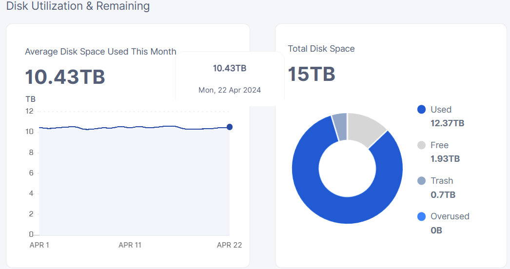

I see that resent days significant amounts of data are wiped on my side. last 1-2 days
