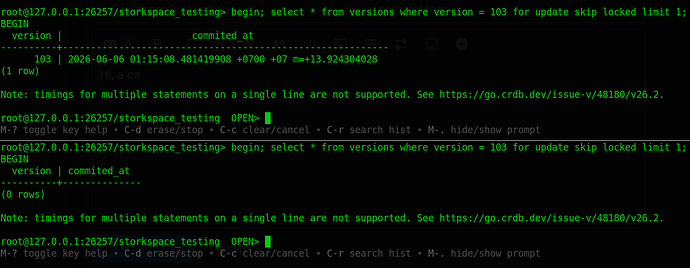

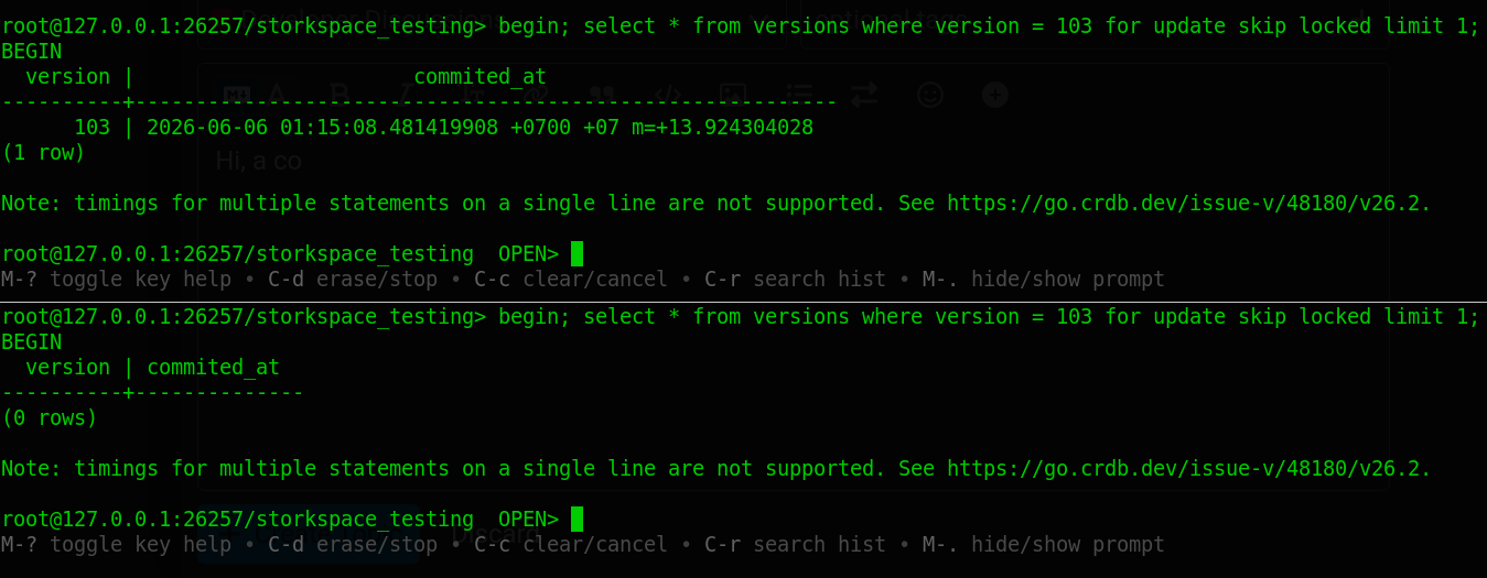

Were you able to take PR for CRDB? right now I’ve 3 commits:
  1. replace 23.2 with latest for docker
  2. merge migration query replace primary key become a single query (so it work with latest)
  3. add skip locked and remove comment about contention
If possible then I’ll create PRs.
