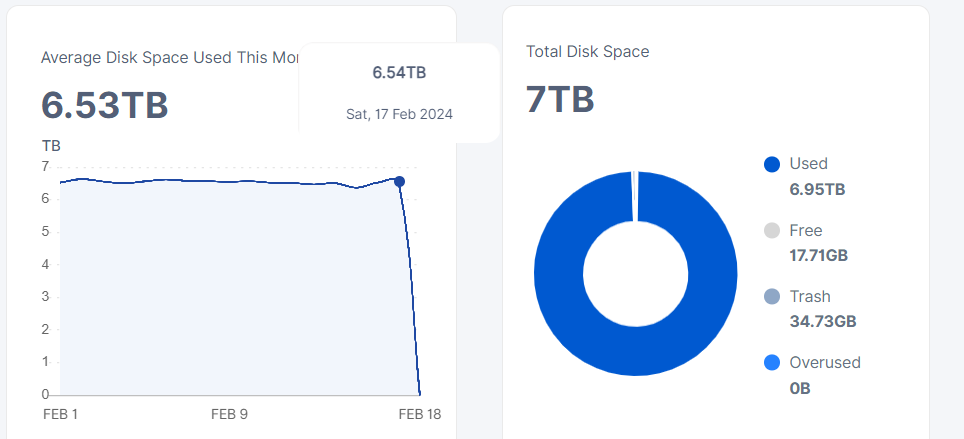

Disk usage discrepancy?
The space of the node plus the trash is larger than the space occupied on the disk.
The size of the trash can has been at the same capacity for a few days.
What could be the problem?
I can’t find any errors in the log.
The trash folder occupies 3.45Gb

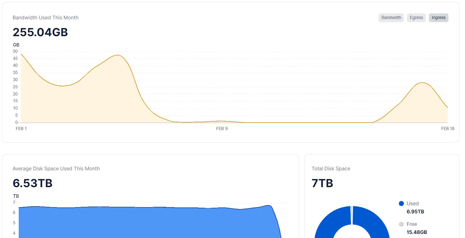

Question is still the same :
Is there a way to recalculate the used space (I have less space in dashboard compared to what is on the disk and it’s not due to filesystem chunk size) ?
I suppose that I have still pieces that can be deleted and maybe I lost some deletion or it failed for some reason.

You can force the scanning, but with a disabled lazy mode, to allow to finish it before the next restart.
This will allow to run a filewalker with a normal priority, it will be more IOPS-hungry, but must finish earlier before the next interruption.
Yes. The only way is to complete a filewalker for each trusted satellite. All untrusted should be removed with this instruction: How To Forget Untrusted Satellites
You may check the finishing:
docker logs storagenode 2>&1 | grep "gc-filewalker" | grep "finish"
docker logs storagenode 2>&1 | grep "used-space-filewalker" | grep "finish"
they should return records for each satellite (4) for each type
docker logs storagenode 2>&1 | grep "retain" | grep "Prepared|Moved"
should return 4 Prepared records and 4 Moved records, 2 per the satellite

Depends on many factors. If you disabled a used space filewalker, it will not appear in the logs, GC is happening 1-2 times per week, so I guess you need to wait more, retain should move pieces weekly.
However, if you switched the log level from the default info, you wouldn’t see records at all. If you redirected logs to the file, then you need to search these records in that file instead.
Storj software uses SI measure units unlike Windows, so 6.23TB Windows (actually - TiB, i.e. power of 2) is 6.85TB in SI (power of 10).
So the difference is like 0.23TB. It’s still too much, but will be collected by the Garbage Collector in the next run (next week), since you do not have any errors related to walk as you said.

According to the logs and the API I am using over 5TB of space for US1. I’ve also ran du -sh and du -sh --apparent-size and both give values over 5TB for US1. However according to the dashboard I am only being paid for about 3.3TB for US1.
With this recent garbage collection I was hoping to have had this discrepancy fixed with the larger bloom filter size, but I’ve only accumulated around 50GB of garbage.
I am running Storj on Unraid on XFS with an SSD write cache, and a block size of 4096 bytes.
Any insights would be helpful. Thanks!

ingress:
So if you are low on RAM, like a rpi or NAS, with 1-4GB, and your node reboots, starts the used-space-FW, than the bloom filter hits, and starts the GC-FW, you’re scr…
It will run for days/weeks! If there is still ingress, than bye bye relaxation for your drive. It will run 100% for a week untill the next Bloom filter, the next update/reboot, and so on…
Just don’t start new nodes on low RAM systems, with big drives!
