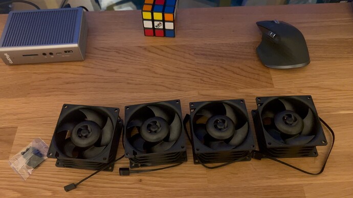

Got the fans home, and have begun doing tests. Looks very promising so far. They are inaudible at 500 RPM, great sounding at 900 and I start to find them annoying at 1400. Maybe I’m very sensitive to sound, or maybe I just don’t like listening to fans, but when I say they sound great at 900 RPM, I mean that they are just smidgen above audible. That is very impressive to me.
Fanspeed is a bit more tricky on Synology, since you work in a 0…255 decimal which corresponds roughly to 0.100% duty cycle of the PWM signal, which then again have a curve on the fans. I don’t have RPM readings in the box - I’m working on a video so you can hear the sound.
Fans come in a convenient 4 pack:
They are 38mm deep compared to the stock fans 32mm and the noctuas 25:
And for whatever reason, the fan caddies in the Synology box is 38mm deep with 6mm spacers. I took out the spacers, and the fans fit perfectly

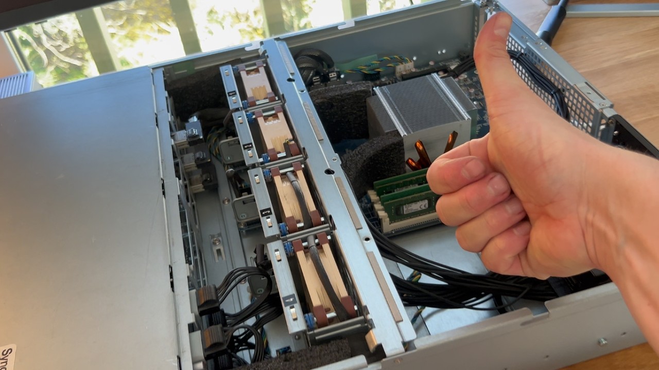

@Solu, It’s a 2u Synology rs3617xs (non plus). I have a couple of rx1217 boxes, that are a chassis design generation newer. They use the same fans albeit only three of them
EDIT: @Solu, as this thread was moved out of the general pictures thread, you might not have seen the video I made about the first state of the upgrade. I’m working on a part two with the fans from above:
