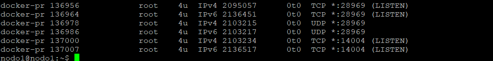

but nothing… i stop, i delete and recreate the docker:
sudo docker run -d --restart unless-stopped --stop-timeout 300 \
    -p 28969:28967/tcp \
    -p 28969:28967/udp \
    -p 14004:14002 \
    -e WALLET="0x7106dee8xxxxxb1452f90c06c7" \
    -e EMAIL="xxxx" \
    -e ADDRESS="xxxx:28969" \
    -e STORAGE="0.9TB" \
    --user $(id -u):$(id -g) \
    --mount type=bind,source="/mnt/storj3/storagenode/identity",destination=/app/identity \
    --mount type=bind,source="/mnt/storj3/",destination=/app/config \
    --name storagenode3 storjlabs/storagenode:latest
any idea?

The problem is not in the identity, but in a wrong port. This port is forwarded to other node. This could happen, if you forwarded this port or port range to the other host and then forwarded this port to the correct host again. But only one rule for the same port could work in time.
This is easy to check - stop your third node and check port 28969 - it should be closed, but in case of wrong port forwarding it will be still opened.
Could you please show your port forwarding rules?
The other way - when your DDNS hostname is updating in two locations, and you have 28969 port in that other location. So one time your DDNS points to one public IP, another time to another.
in router i try 28967-28968 it ok problem it 28969-28970
i try to put same external port.
and if i stop node3 in this case, and use lsof -i -n -p i dont see ports udp up, but if i start my node can i saw the ports up:
so this image it for this:
sudo docker run -d --restart unless-stopped --stop-timeout 300     -p 28969:28967/tcp     -p 28969:28967/udp     -p 14004:14002     -e WALLET="0x7106dee8176fa63efbdf5c5946ab1452f90c06c7"     -e EMAIL="xxxxx"     -e ADDRESS="xxxxx:28969"     -e STORAGE="xxTB"     --user $(id -u):$(id -g)     --mount type=bind,source="~/.local/share/storj/identity/node3",destination=/app/identity     --mount type=bind,source="/mnt/storj3/",destination=/app/config     --name storagenode3 storjlabs/storagenode:latest
with this it closed
with this it open
imagen
and docker it online, thnks :wink:
The rule for 7778-7779 should be deleted, it’s private.
