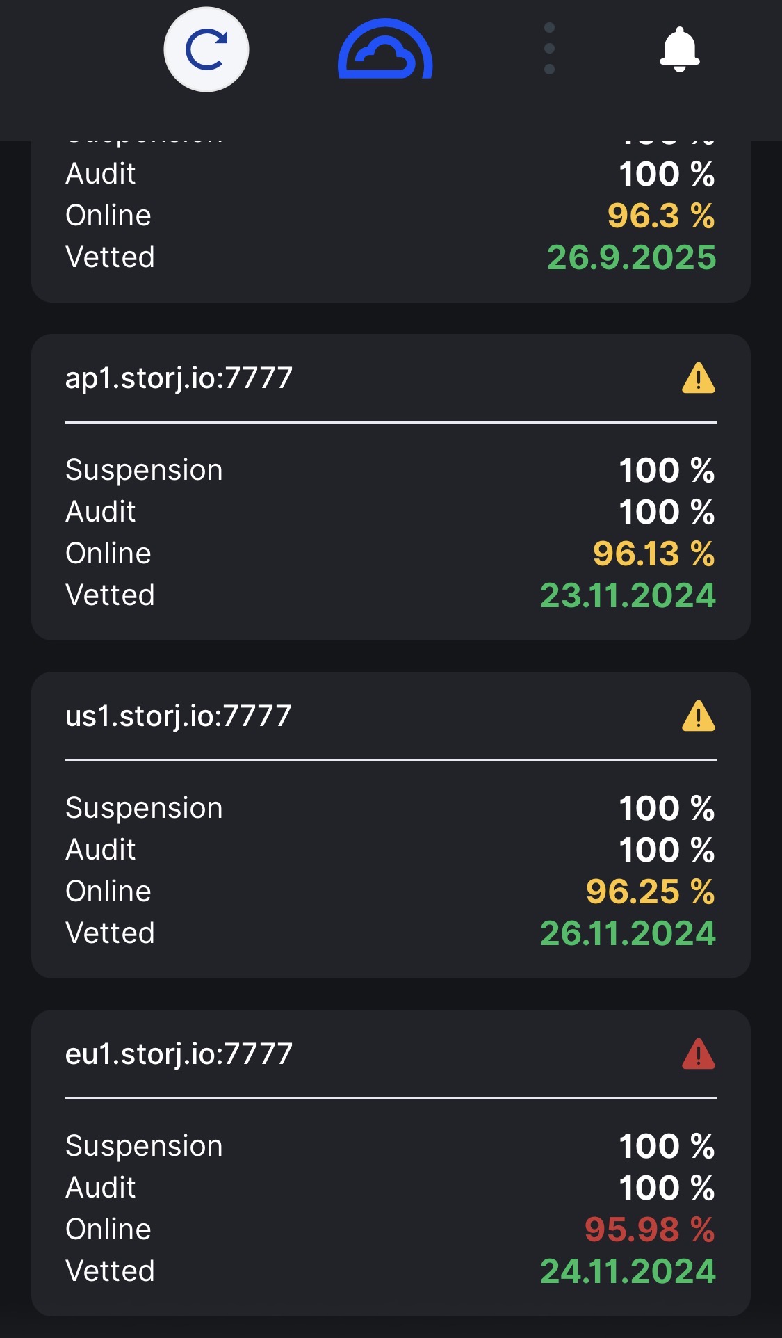

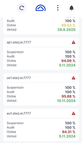

Now I’m starting to worry too, all my nodes have dropped below 95% in the past few weeks.
are you using VPN or VPS to route traffic?
I have three nodes. One in my house with direct internet access, two in other apartments where the internet is under cgnat. Each of them accesses the internet through a separate vpn->vps provider. The containers running on the Synologys build a vpn tunnel and go to the internet with the vps ip.
The score of all three nodes is constantly decreasing.
This coloring code is a copy-paste of audit/suspension scores, however, the online score has different thresholds - below 60% - should be yellow (the node is suspended), below 25% - should be orange (close to disqualification), 0% - should be red (disqualification).
