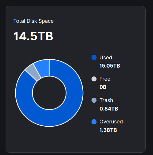

Lazy filewalker finally finished all four satellites a while ago.
Dashboard is still completely wrong. Hasn’t changed at all in fact. My disk has around 14G out of 16TB free at the moment.
I still have the databases on an SSD and there are no “database locked” errors whatsoever.

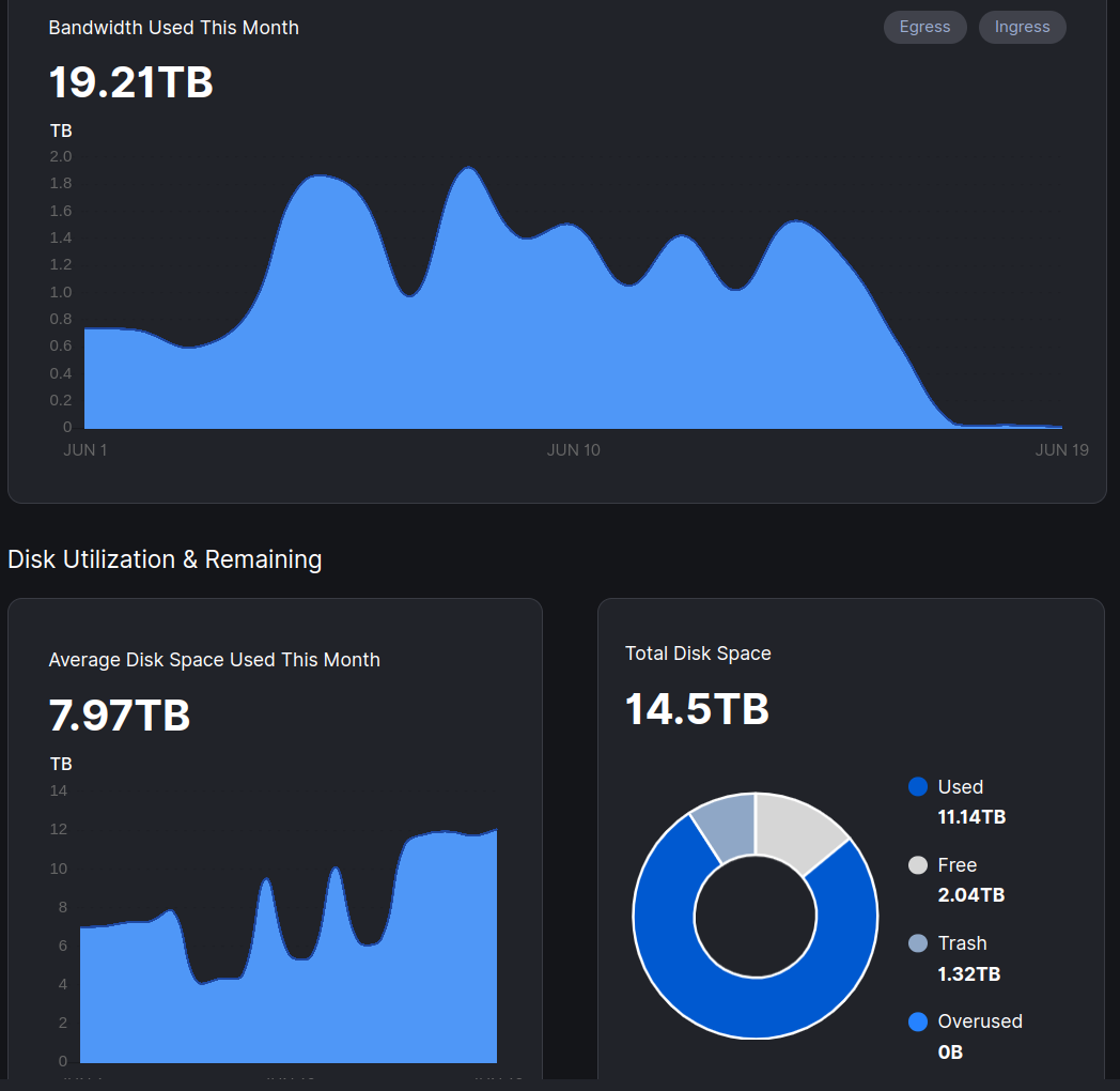

Not sure why it took so long but my dashboard has finally updated:

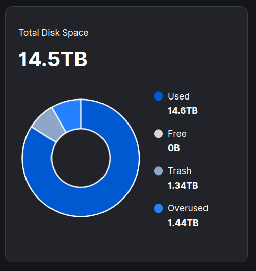

Let me repost here what I posted a few days ago - what I got after 4 filewalkers finished and a few additional hours went by:
Then, over the next day, a bunch of trash accumulated, dropping my used space down to 14.6TB, so I figured once all trash got deleted I’d be pretty close to what I’d allocated, 14.5TB, and maybe I’d be back to normal.
But then I got autoupdated to 1.105.4 a couple days ago, obviously restarting my node. And that undid all of that movement from used space to trash:
It has looked like that ever since, nearly 2 days now, and still looking like it’s going to take 4 days to refinish the filewalkers.
Yes, it’s true. The 1.104.x version has a bug related to not updated info for the trash. But If the used-space-filewalker is enabled, it should update the stat after the restart. This new version (1.105.x) has a fix for not updating databases by the trash filewalker, so I would hope that your databases now would keep the updated info and it would be close to the used space on the disk.
