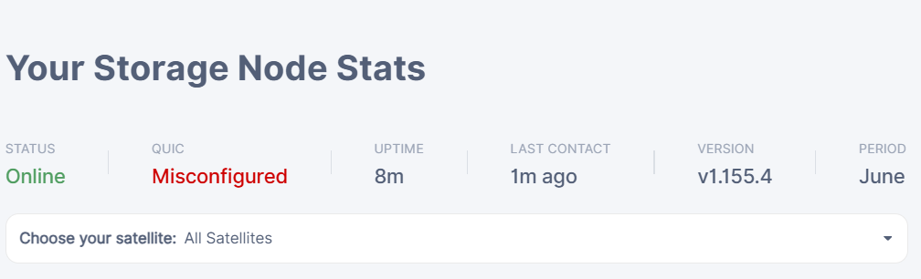

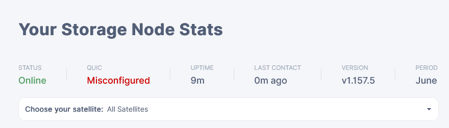

Same here, all 4 of my nodes are showing the same issue. A restart didn’t fix it.

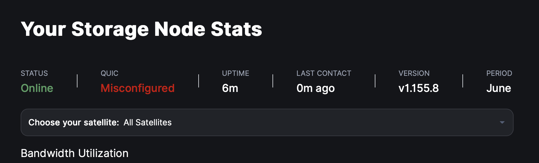

I got same here started about 40 mins ago looks same. I didnt change anything and its also say Missconfg and stop DL/UP. I had checked also port say - Port 28967 is open so…
Still, had checked all but Misconfigured, ports open. Any tech. supp.?
Same issue here all show misconfigured.
Storj status site shows AP EU US online. Might be an issue on storj’s side with salt lake?

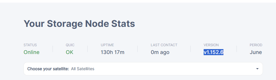

I have 1 node on v1.152.6 still … - this has OK

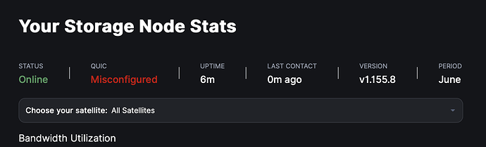

How You do that? It turn auto? My all still Miss V1.155.8
It keeps failing, we have to wait
Hmm I got offline alert
Starting to go back to normal
Don’t trust it yet :smiling_face_with_tear:
For me still missing :<

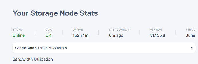

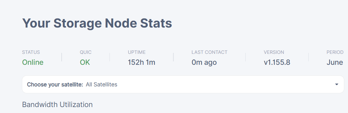

Now v1.155.8 works Ok but V1.152.6 i have still miss.

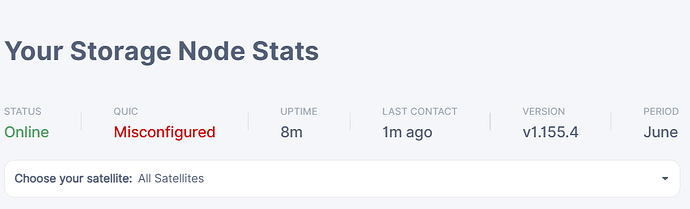

Also having similar issues on 1.155.4
