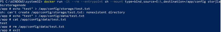

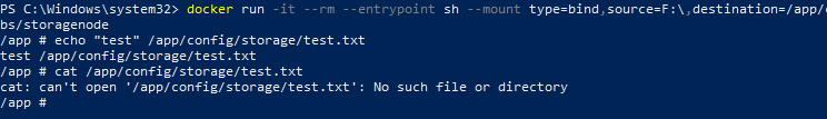

Please, try to do:
docker run -it --rm --entrypoint sh --mount type=bind,source=F:\,destination=/app/config storjlabs/storagenode
When you see prompt:
echo "test" > /app/config/storage/test.txt
cat /app/config/storage/test.txt
rm /app/config/storage/test.txt
exit
Please, post results

You missed > in the first command, please, try again

Looks like the storage is writeable.

Oh, you used a subfolder on disk, not the root of the disk.
Then we should repeat the test but for subfolder
docker run -it --rm --entrypoint sh --mount type=bind,source=F:\data,destination=/app/config storjlabs/storagenode
When you see a prompt, execute this:
exit
Please, post results.
