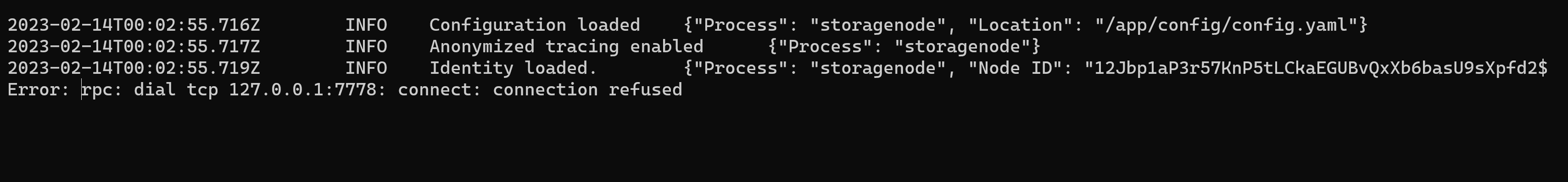

Error: rpccompat: dial tcp 127.0.0.1:7778: connect: connection refused

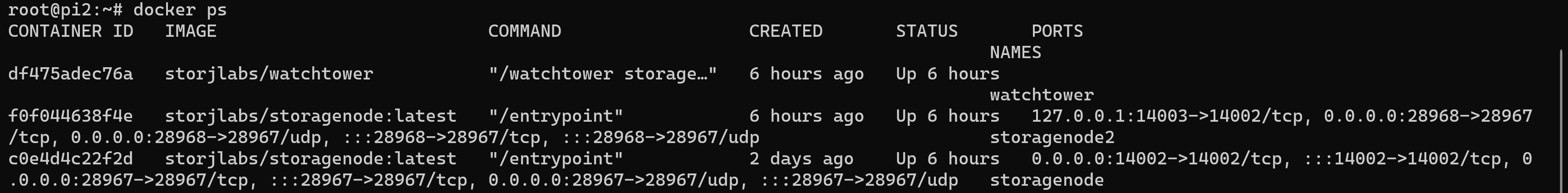

docker exec -it storagenode2 /app/dashboard
Type
docker ps
It should list the containers that are running.
I notice some differences between node1 and node2. What could cause this?
What differences do you mean? They are both running so you can check the logs to see their status.
Node1 is showing:
0.0.0.0:14002->14002/tcp, :::14002->14002/tcp
Node2 is only showing:
127.0.0.1:14003->14002/tcp
I understand the ā€œ14003->14002ā€ in node2.
I need help understanding why node1 uses ā€œ0.0.0.0ā€ and node2 uses ā€œ127.0.0.1ā€
I need help understanding why node2 does not have the second set of numbers ā€œ:::14003->14002/tcpā€ could the cause in variation prevent the node from communicating with the dashboards?

In your run command you specified 127.0.0.1 on the one node and the other you removed the IP. Typically you remove the IP so you can access the dashboard from a different computer than the host.

in this case you need to run the dashboard with providing a port
docker exec -it storagenode2 ./dashboard.sh --server.private-address=127.0.0.1:7779
But usually you should not change anything in the config.yaml file if you use a docker version, unless you are using --network host.
So, you may return the private address back to default,
server.private-address: 127.0.0.1:7778
Then docker exec -it storagenode2 ./dashboard.sh should work.

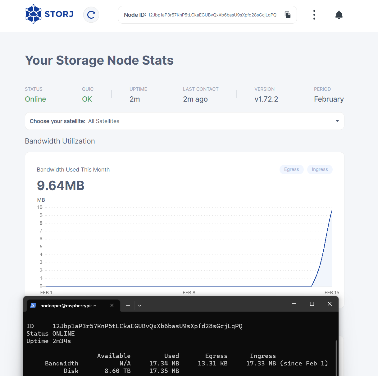

The recommendations above allowed me to see the node’s dashboard via CLI.
It was showing offline. I went to my router, changed some port forwarding stuff. Now, I am REALLY confused. The docker run command uses ports 28968 and 28967 while the port forwarding rule is for 28968 only. No need to explain this. Its green and green. I’m showing ingress and egress, so its good and working, I don’t need to know how. Unless you just want to point me towards some resources so I can read up on it.
But, thank you so much @Alexey I literally could not have done this without your help. I really appreciate it!

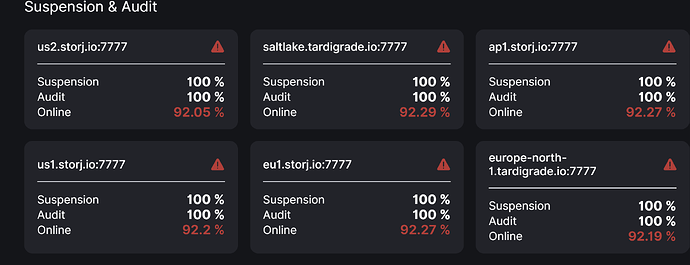

Here is a screen shot. Yesterday I was in the 80’s fyi. So, if you can somehow manage to get the drive and node back online within 3 days, you should be okay.
