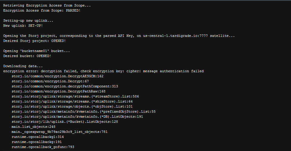

Hello Everyone,
I have been trying to use restrict_scope function in uplinkc. I want to use restricted scope to access some object uploaded on a bucket using API Key and Encryption PassPhrase. I am using "lib/uplinkc v0.28.4" functions for this.
Steps and functions involved in uploading data:
  1. new_uplink
  2. parse_api_key
  3. open_project
  4. project_salted_key_from_passphrase
  5. new_encryption_access_with_default_key
  6. serialize_encryption_access
  7. open_bucket
  8. upload
  9. upload_write
  10. upload_commit
The data is successfully uploaded on storj and can be accessed/downloaded using uplink CLI.
Bucket: "bucketname01" Object Path: "uploadPath01/data/README.md"
Further Scope is created using new_scope function with returned objects from above “parse_api_key” and “new_encryption_access_with_default_key” functions.
The created scope is then restricted using restrict_scope function with parameters as:
Caveat caveat = {disallow_deletes : true};
EncryptionRestriction restrictions[] = {
            {"bucketname01", "uploadPath01/data"}};
Steps involved in downloading data using restricted scope:
  1. get_scope_satellite_address
  2. get_scope_api_key
  3. get_scope_enc_access
  4. serialize_encryption_access
  5. new_uplink
  6. open_project
  7. open_bucket
  8. download
  9. download_read
  10. download_close
It works properly till open bucket but fails to download object data.
Error: unable to find encryption base for: bucketname01/“”
If I add this path to restrictions, I get the following error:
            {"bucketname01", ""},
Error: encryption error: decryption failed, check encryption key: cipher: message authentication failed
If I try the above steps without using restrict_scope function, it successfully downloads object data.
Please let me know what may be the issue and if I am doing something wrong ?

Sorry Sir, but to share the code that would demonstrate the issue, complete project need to be shared because all the functions are interlinked. You can use the test examples in lib/uplinkc to test the issue.
I have tested the same procedure using uplink instead of uplinkc and it works like a charm.
I think there is an issue with the restrict_scope function of uplinkc. If possible please try to download or upload using restricted scope created using uplinkc. This might recreate the issue.
