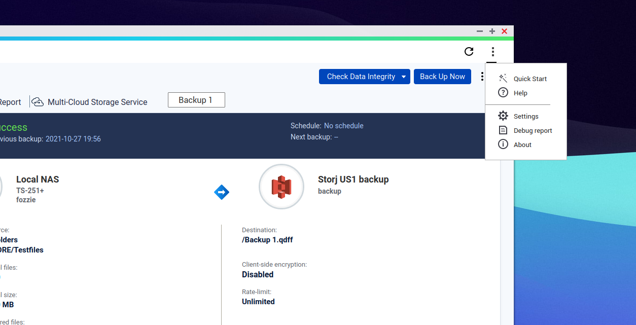

Hi @jensamberg, I discovered there are some more detailed logs you can retrieve from HBS. If you go to the top right menu and hit “Debug report” you’ll get a zip file. Here’s what it looks like for me:
Inside the zip there is the folder system/Backup 1/log (in my case, the backup was called “Backup 1”, so it might be different for you). backupengine-error.log here looks the most interesting. I took a look, and saw a bunch of timeout errors for my backups. Could you share what you’re able to see in this file?
