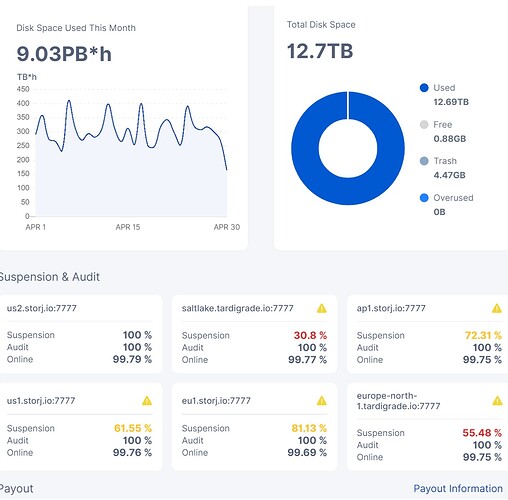

So this is still an issue. I have 5 nodes all on 1.53.1, and two of my nodes (both in different locations) are having suspensions.
The below is focused on my main node: 1765RRSLTetCWq9omHzemihN3GzAgXhgbNNxDJ77t6tj6ejxLF,
This node is suspended on 3 satellites:
  • 121RTSDpyNZVcEU84Ticf2L1ntiuUimbWgfATz21tuvgk3vzoA6
  • 12L9ZFwhzVpuEKMUNUqkaTLGzwY9G24tbiigLiXpmZWKwmcNDDs
  • 12rfG3sh9NCWiX3ivPjq2HtdLmbqCrvHVEzJubnzFzosMuawymB
Looking in the logs, I’m still seeing errors related to this issue:
Satellite 121RTSDpyNZVcEU84Ticf2L1ntiuUimbWgfATz21tuvgk3vzoA6:
2022-04-28T15:05:11.549-0400    ERROR   piecestore      download failed {"Process": "storagenode", "Piece ID": "U5PTPG6PVU7ZX53OUI6ETCJUG2NP4UHTLXG6U5ZPINOWELJY72GQ", "Satellite ID": "121RTSDpyNZVcEU84Ticf2L1ntiuUimbWgfATz21tuvgk3vzoA6", "Action": "GET_REPAIR", "error": "used serial already exists in store", "errorVerbose": "used serial already exists in store\n\tstorj.io/storj/storagenode/piecestore/usedserials.insertSerial:263\n\tstorj.io/storj/storagenode/piecestore/usedserials.(*Table).Add:117\n\tstorj.io/storj/storagenode/piecestore.(*Endpoint).verifyOrderLimit:76\n\tstorj.io/storj/storagenode/piecestore.(*Endpoint).Download:498\n\tstorj.io/common/pb.DRPCPiecestoreDescription.Method.func2:228\n\tstorj.io/drpc/drpcmux.(*Mux).HandleRPC:33\n\tstorj.io/common/rpc/rpctracing.(*Handler).HandleRPC:58\n\tstorj.io/drpc/drpcserver.(*Server).handleRPC:122\n\tstorj.io/drpc/drpcserver.(*Server).ServeOne:66\n\tstorj.io/drpc/drpcserver.(*Server).Serve.func2:112\n\tstorj.io/drpc/drpcctx.(*Tracker).track:52"}
2022-04-28T15:07:01.508-0400    ERROR   piecestore      download failed {"Process": "storagenode", "Piece ID": "S4X3CFM6LKJIX4DJ7YDSK45M2OBAFLH2Q3JC35GUMBVYNBIT3BLA", "Satellite ID": "121RTSDpyNZVcEU84Ticf2L1ntiuUimbWgfATz21tuvgk3vzoA6", "Action": "GET_REPAIR", "error": "used serial already exists in store", "errorVerbose": "used serial already exists in store\n\tstorj.io/storj/storagenode/piecestore/usedserials.insertSerial:263\n\tstorj.io/storj/storagenode/piecestore/usedserials.(*Table).Add:117\n\tstorj.io/storj/storagenode/piecestore.(*Endpoint).verifyOrderLimit:76\n\tstorj.io/storj/storagenode/piecestore.(*Endpoint).Download:498\n\tstorj.io/common/pb.DRPCPiecestoreDescription.Method.func2:228\n\tstorj.io/drpc/drpcmux.(*Mux).HandleRPC:33\n\tstorj.io/common/rpc/rpctracing.(*Handler).HandleRPC:58\n\tstorj.io/drpc/drpcserver.(*Server).handleRPC:122\n\tstorj.io/drpc/drpcserver.(*Server).ServeOne:66\n\tstorj.io/drpc/drpcserver.(*Server).Serve.func2:112\n\tstorj.io/drpc/drpcctx.(*Tracker).track:52"}
Satellite 12L9ZFwhzVpuEKMUNUqkaTLGzwY9G24tbiigLiXpmZWKwmcNDDs:
2022-04-28T16:08:20.002-0400    ERROR   piecestore      download failed {"Process": "storagenode", "Piece ID": "AH42O3T5FHCQ4Q5LD7SDTTFONUWNFWZJ2OY3HGSZTP4OL7J2P6XQ", "Satellite ID": "12L9ZFwhzVpuEKMUNUqkaTLGzwY9G24tbiigLiXpmZWKwmcNDDs", "Action": "GET_REPAIR", "error": "used serial already exists in store", "errorVerbose": "used serial already exists in store\n\tstorj.io/storj/storagenode/piecestore/usedserials.insertSerial:263\n\tstorj.io/storj/storagenode/piecestore/usedserials.(*Table).Add:117\n\tstorj.io/storj/storagenode/piecestore.(*Endpoint).verifyOrderLimit:76\n\tstorj.io/storj/storagenode/piecestore.(*Endpoint).Download:498\n\tstorj.io/common/pb.DRPCPiecestoreDescription.Method.func2:228\n\tstorj.io/drpc/drpcmux.(*Mux).HandleRPC:33\n\tstorj.io/common/rpc/rpctracing.(*Handler).HandleRPC:58\n\tstorj.io/drpc/drpcserver.(*Server).handleRPC:122\n\tstorj.io/drpc/drpcserver.(*Server).ServeOne:66\n\tstorj.io/drpc/drpcserver.(*Server).Serve.func2:112\n\tstorj.io/drpc/drpcctx.(*Tracker).track:52"}
2022-04-28T16:08:35.299-0400    ERROR   piecestore      download failed {"Process": "storagenode", "Piece ID": "HO5KVYHPFFW2HYJH2O64JHTKCMJEJ2UHN2SKI6NOGK4XYJBS6U4Q", "Satellite ID": "12L9ZFwhzVpuEKMUNUqkaTLGzwY9G24tbiigLiXpmZWKwmcNDDs", "Action": "GET_REPAIR", "error": "used serial already exists in store", "errorVerbose": "used serial already exists in store\n\tstorj.io/storj/storagenode/piecestore/usedserials.insertSerial:263\n\tstorj.io/storj/storagenode/piecestore/usedserials.(*Table).Add:117\n\tstorj.io/storj/storagenode/piecestore.(*Endpoint).verifyOrderLimit:76\n\tstorj.io/storj/storagenode/piecestore.(*Endpoint).Download:498\n\tstorj.io/common/pb.DRPCPiecestoreDescription.Method.func2:228\n\tstorj.io/drpc/drpcmux.(*Mux).HandleRPC:33\n\tstorj.io/common/rpc/rpctracing.(*Handler).HandleRPC:58\n\tstorj.io/drpc/drpcserver.(*Server).handleRPC:122\n\tstorj.io/drpc/drpcserver.(*Server).ServeOne:66\n\tstorj.io/drpc/drpcserver.(*Server).Serve.func2:112\n\tstorj.io/drpc/drpcctx.(*Tracker).track:52"}
2022-04-28T16:08:42.946-0400    ERROR   piecestore      download failed {"Process": "storagenode", "Piece ID": "DWGTZBXAWNEOZE2JMRFPUI6F7C3Y37XF7URONCIYKNBIRCDSNEGA", "Satellite ID": "12L9ZFwhzVpuEKMUNUqkaTLGzwY9G24tbiigLiXpmZWKwmcNDDs", "Action": "GET_REPAIR", "error": "used serial already exists in store", "errorVerbose": "used serial already exists in store\n\tstorj.io/storj/storagenode/piecestore/usedserials.insertSerial:263\n\tstorj.io/storj/storagenode/piecestore/usedserials.(*Table).Add:117\n\tstorj.io/storj/storagenode/piecestore.(*Endpoint).verifyOrderLimit:76\n\tstorj.io/storj/storagenode/piecestore.(*Endpoint).Download:498\n\tstorj.io/common/pb.DRPCPiecestoreDescription.Method.func2:228\n\tstorj.io/drpc/drpcmux.(*Mux).HandleRPC:33\n\tstorj.io/common/rpc/rpctracing.(*Handler).HandleRPC:58\n\tstorj.io/drpc/drpcserver.(*Server).handleRPC:122\n\tstorj.io/drpc/drpcserver.(*Server).ServeOne:66\n\tstorj.io/drpc/drpcserver.(*Server).Serve.func2:112\n\tstorj.io/drpc/drpcctx.(*Tracker).track:52"}
Satellite 12rfG3sh9NCWiX3ivPjq2HtdLmbqCrvHVEzJubnzFzosMuawymB:
2022-04-28T16:06:26.044-0400    ERROR   piecestore      download failed {"Process": "storagenode", "Piece ID": "QK6XTWVYTY7MDEN62U4GJS5PUFPMR6ZGDO3I6TCQ6THDAAMKGBIQ", "Satellite ID": "12rfG3sh9NCWiX3ivPjq2HtdLmbqCrvHVEzJubnzFzosMuawymB", "Action": "GET_REPAIR", "error": "used serial already exists in store", "errorVerbose": "used serial already exists in store\n\tstorj.io/storj/storagenode/piecestore/usedserials.insertSerial:263\n\tstorj.io/storj/storagenode/piecestore/usedserials.(*Table).Add:117\n\tstorj.io/storj/storagenode/piecestore.(*Endpoint).verifyOrderLimit:76\n\tstorj.io/storj/storagenode/piecestore.(*Endpoint).Download:498\n\tstorj.io/common/pb.DRPCPiecestoreDescription.Method.func2:228\n\tstorj.io/drpc/drpcmux.(*Mux).HandleRPC:33\n\tstorj.io/common/rpc/rpctracing.(*Handler).HandleRPC:58\n\tstorj.io/drpc/drpcserver.(*Server).handleRPC:122\n\tstorj.io/drpc/drpcserver.(*Server).ServeOne:66\n\tstorj.io/drpc/drpcserver.(*Server).Serve.func2:112\n\tstorj.io/drpc/drpcctx.(*Tracker).track:52"}
2022-04-28T16:06:26.692-0400    ERROR   piecestore      download failed {"Process": "storagenode", "Piece ID": "Q3XCJPLTVH3ITBTJL5JPQFBFQLR6HN6JBS7HNFWHBWI3FMQLHDGQ", "Satellite ID": "12rfG3sh9NCWiX3ivPjq2HtdLmbqCrvHVEzJubnzFzosMuawymB", "Action": "GET_REPAIR", "error": "used serial already exists in store", "errorVerbose": "used serial already exists in store\n\tstorj.io/storj/storagenode/piecestore/usedserials.insertSerial:263\n\tstorj.io/storj/storagenode/piecestore/usedserials.(*Table).Add:117\n\tstorj.io/storj/storagenode/piecestore.(*Endpoint).verifyOrderLimit:76\n\tstorj.io/storj/storagenode/piecestore.(*Endpoint).Download:498\n\tstorj.io/common/pb.DRPCPiecestoreDescription.Method.func2:228\n\tstorj.io/drpc/drpcmux.(*Mux).HandleRPC:33\n\tstorj.io/common/rpc/rpctracing.(*Handler).HandleRPC:58\n\tstorj.io/drpc/drpcserver.(*Server).handleRPC:122\n\tstorj.io/drpc/drpcserver.(*Server).ServeOne:66\n\tstorj.io/drpc/drpcserver.(*Server).Serve.func2:112\n\tstorj.io/drpc/drpcctx.(*Tracker).track:52"}
2022-04-28T16:07:01.705-0400    ERROR   piecestore      download failed {"Process": "storagenode", "Piece ID": "ZUXDOG6RYHZGJKZWSGSMTZ3LCRMKQYMWE6YHUXJJQ4JBI3UEFNHA", "Satellite ID": "12rfG3sh9NCWiX3ivPjq2HtdLmbqCrvHVEzJubnzFzosMuawymB", "Action": "GET_REPAIR", "error": "used serial already exists in store", "errorVerbose": "used serial already exists in store\n\tstorj.io/storj/storagenode/piecestore/usedserials.insertSerial:263\n\tstorj.io/storj/storagenode/piecestore/usedserials.(*Table).Add:117\n\tstorj.io/storj/storagenode/piecestore.(*Endpoint).verifyOrderLimit:76\n\tstorj.io/storj/storagenode/piecestore.(*Endpoint).Download:498\n\tstorj.io/common/pb.DRPCPiecestoreDescription.Method.func2:228\n\tstorj.io/drpc/drpcmux.(*Mux).HandleRPC:33\n\tstorj.io/common/rpc/rpctracing.(*Handler).HandleRPC:58\n\tstorj.io/drpc/drpcserver.(*Server).handleRPC:122\n\tstorj.io/drpc/drpcserver.(*Server).ServeOne:66\n\tstorj.io/drpc/drpcserver.(*Server).Serve.func2:112\n\tstorj.io/drpc/drpcctx.(*Tracker).track:52"}
2022-04-28T16:07:23.193-0400    ERROR   piecestore      download failed {"Process": "storagenode", "Piece ID": "OG6IMSNWHSQOYI76DRAJHQQLSJLCYY6ZPFRUV7YH2CL7JZ55K6HQ", "Satellite ID": "12rfG3sh9NCWiX3ivPjq2HtdLmbqCrvHVEzJubnzFzosMuawymB", "Action": "GET_REPAIR", "error": "used serial already exists in store", "errorVerbose": "used serial already exists in store\n\tstorj.io/storj/storagenode/piecestore/usedserials.insertSerial:263\n\tstorj.io/storj/storagenode/piecestore/usedserials.(*Table).Add:117\n\tstorj.io/storj/storagenode/piecestore.(*Endpoint).verifyOrderLimit:76\n\tstorj.io/storj/storagenode/piecestore.(*Endpoint).Download:498\n\tstorj.io/common/pb.DRPCPiecestoreDescription.Method.func2:228\n\tstorj.io/drpc/drpcmux.(*Mux).HandleRPC:33\n\tstorj.io/common/rpc/rpctracing.(*Handler).HandleRPC:58\n\tstorj.io/drpc/drpcserver.(*Server).handleRPC:122\n\tstorj.io/drpc/drpcserver.(*Server).ServeOne:66\n\tstorj.io/drpc/drpcserver.(*Server).Serve.func2:112\n\tstorj.io/drpc/drpcctx.(*Tracker).track:52"}
Above are just to name a few of them. This particular node has been running 1.53.1 for ~57 hours.
Any help on this? I haven’t received any suspension emails this time around, and I don’t like having to keep checking the dashboards to see if I’m suspended.
This also isn’t an I/O issue or network issue for me. I’ve got 1GBps internet (and a 5% utilization), along with a multi-disk array with low I/O (and dedicated disks just to Storj).
