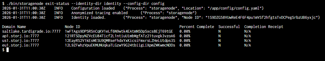

@Climbingkid please provide an output of the storagenode exit-status command
So GE process definitely started, and I watched as all incoming traffic stopped.
I cannot copy / paste text from TN shell for some reason, so excuse the screenshot of exit status, I had to point at my config and identity to avoid errors.
Thanks
CC
Did you followed my instructions? Nothing bad happens if you restart the GE on a node that already has GE in progress. It will only sync it’s status with sats. Dosen’t restart at the begining.
From your screenshot you are in one of the following situations:
  1. your node restarted and gone “out of sync” with sats.
  2. you started GE less than 30 daya ago.
I speak from expirience. I GE with the old way and the new way, so I encountered all situations.
