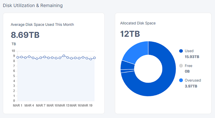

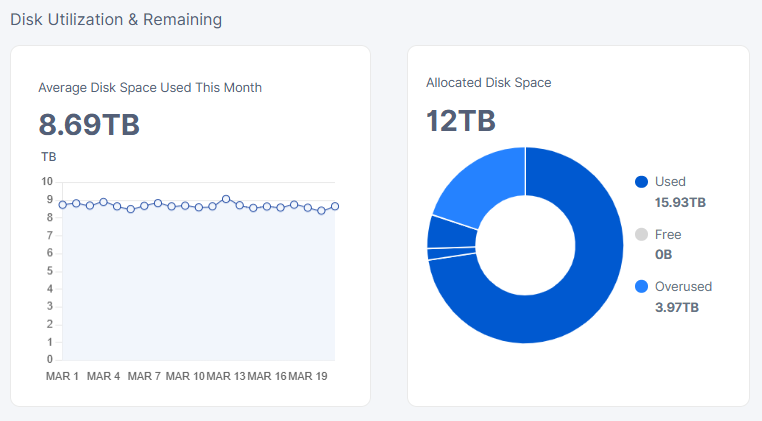

My node2 completed the migration two weeks ago. However, the values ​​are not real. The real utilization: 12 TB of total storage, of which 9.2 TB is occupied. The system shows a lot of overload. I waited two weeks, hoping that some task would fix it, but today I stopped the container, renamed it to used_space_per_prefix.db, but it didn’t change even by evening. There is not much traffic due to the overallocation. Do I need to enable some file mover? Thanks.
I found the error, I messed it up. I forgot that the dbs were on another ssd volume, I left them in the old location, so I got confused… :confused:
