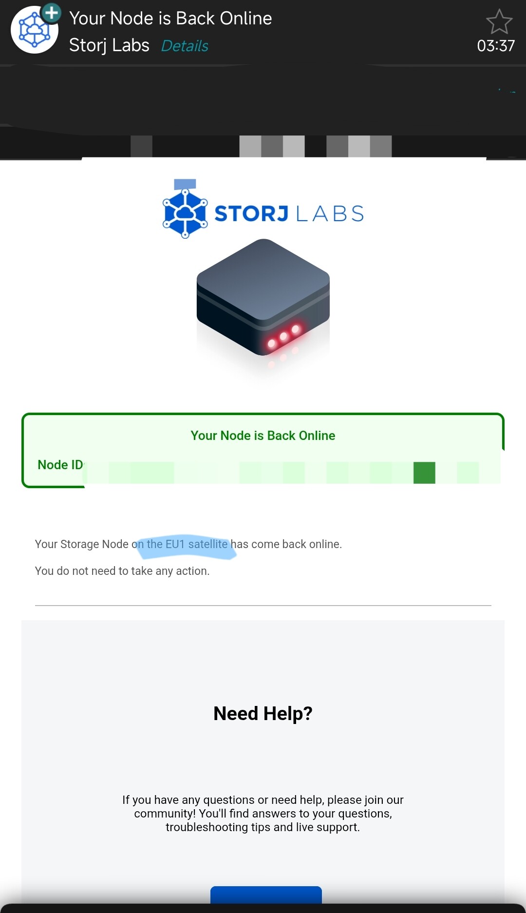

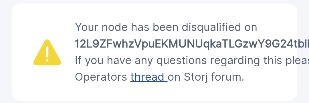

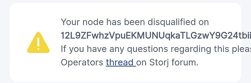

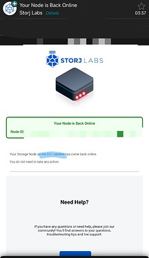

Unfortunately, this only works temporarily for me, because the satellite comes back!
After executing the commands, the message disappears and everything seems to be fine.
But after a while, I receive an email saying that my node is back online on the satellite… Hmm?
And yes, the message is back again too :face_exhaling:
You need also add it to the exclusion list, since the satellite is not removed from the trusted list, the node would contact it again, because now it does not remember (:fish:), that’s disqualified on that satellite :person_shrugging:
