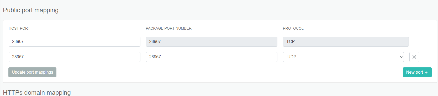

Hi Alexey yes, I have read that and still encounter the error, despite entering the cmd on linux and opening port udp and tcp on my router.
You also need to update your docker run command to port map the udp, i.e. -p 28967:28967/tcp -p 28967:28967/udp
Since you mention the DAppNode, I think you need to add an issue to their repo to update their docker run command with UDP.
Okay settled it on the backend … lol
Will make an issue on the repo thx Alexey much appreciated :smiley:
