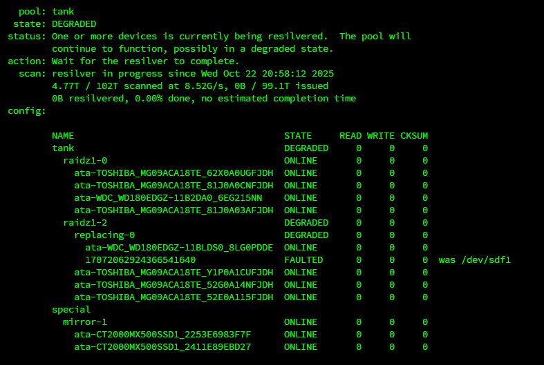

Recovering the Partition Table unfortunately did not work, testdisk wrote over everyting. But the “transplantation” of the partition table with a new UUID worked unnexpected well, the toshiba got recognized instantly, like nothing happened. The On/Off WD seem to work. I have to say, I now added all sata cables fromt the PSU to the Bays, until now I hat one wire with 3 Sata connnectors, each had a y-cable, to feed all 3 Bays with 2 sockets each, maybe it was too much for one powerline. Unfortunately as I was trying to resilver the “defective” HDD, yesterday, the new Drive now is faulted which doesn’t matter, since it’s a pretty empty one (I can use the old one). For looks I will try to remove it later.
Yes something like that.
Much better. It’s possible/likely that one of these “y-cables” caused your whole problem. Many low quality examples exist, very difficult to obtain good quality ones.
You can do a lot to a ZFS pool before you kill it.
When I create an array, I partition the disks myself prior to creating pool/vdev, then feed ZFS the partition instead of whole device.
The second small partition openZFS has created on your drives is redundant and not required, can safely be deleleted - you can extend the ZFS partition if you really want that space…..
I don’t know if testdisk did a bad job at recovering the partition table with just one big partition and 3M left instead of 9M (8M spare partition + 1M (If a new drive is slightly smaller I think). The drive wouldn’t be recognized anymore. I’m lucky copying the partition table worked, so I don’t care for the additional 8M space :smiley:
