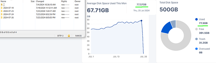

AP1 is doing well this week with bloom filters. I now have 4 trash date folders and the used space according to the server is now very close to the used space calculated by the file walker(this node only stores AP1 customer data).
SFTP-3?
Did you mount a storage as a SFTP?
This is WinSCP used for browsing the folders.
No, The screenshot was taken from windows. That window on the left is a program called WinSCP. I use it for remote browsing and transferring of files from my windows computer to my Raspberry pi (where the storage node is).

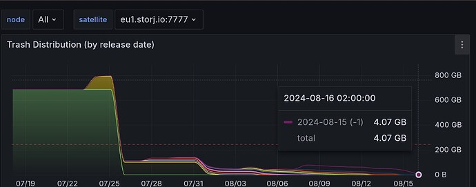

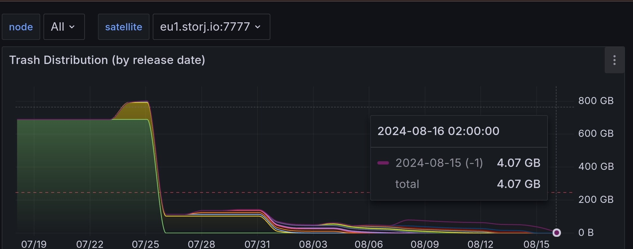

My last bloom filter for the EU1 satellite was about 9 days ago. My node uptime is 99.91%.
2024-08-07T22:34:49Z    INFO    piecestore      Retain job queued       {"Process": "storagenode", "Satellite ID": "12L9ZFwhzVpuEKMUNUqkaTLGzwY9G24tbiigLiXpmZWKwmcNDDs"}
Based on the tally report for EU1, I’m currently storing 73% customer data and 27% garbage for this satellite.
Anybody else not getting bloom filters for EU1?
I can confirm. My last BF from EU1 is about a week ago:
2024-08-09T03:25:15Z    INFO    retain  Prepared to run a Retain request.       {"Process": "storagenode", "cachePath": "config/retain", "Created Before": "2024-08-03T17:59:59Z", "Filter Size": 884779, "Satellite ID": "12L9ZFwhzVpuEKMUNUqkaTLGzwY9G24tbiigLiXpmZWKwmcNDDs"}
I also haven’t received BFs for EU1 for the past week or so.
2024-08-18T02:12:57Z    INFO    retain  Prepared to run a Retain request.       {"Process": "storagenode", "cachePath": "config/retain", "Created Before": "2024-08-13T17:59:59Z", "Filter Size": 901251, "Satellite ID": "12L9ZFwhzVpuEKMUNUqkaTLGzwY9G24tbiigLiXpmZWKwmcNDDs"}
In my case seems interval is 9 days.
