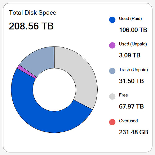

Why is this garbage not paid for SNO? Why does taking care of customers come at the expense of node operators’ income?
For example, I already have ~35 TB of unpaid garbage stored, and that’s ~$50 per month. The garbage collection problem has been going on for a LOOOOONG time!

2.96TB trash on my oldest node. Hoorey!
wait i can’t keep track if I want lots of trash or not, it’s an emotional roller coaster :).
my largest amount is about 690MB of trash with 3.71TB used right now.
