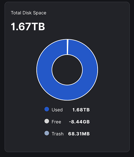

Good point regarding the no space available. Last month you may not believe me now :see_no_evil: but I did have 300gb odd free for a week or so with still 0 bytes ingress. Today though I’m seeing below…I did keep to the advice set as well when setting up to reserve x amount on the hdd.

There was a code change in v1.12.3 that caused the free space to be displayed as disk (volume) free space instead of allocated free space if that node had large amounts of trash or if the free space was negative. This was reverted in v1.14.4 so that the node will now show negative space instead of the disk (volume) free space. So you are probably not crazy.

Should I be concerned about the -8.4GB in the ‘Free’ section? I have 287GB of Egress this month so far so seems to be working fine on that side.
the free space is of the allocated space you select in the docker run command…
so you could have a 10TB hdd with only 1tb space allocated and then it having 1.01tb and thus having 0.01tb over max but still having 8.99tb free

If you actually have free space on the disk it will not be a problem. If you physically do not have a free space, then it’s problem - the storagenode will not be able to update databases and thus you will not be paid for egress and storage, because storagenode can’t store orders and thus nothing to submit to satellite.
This is one of the reason why we suggesting to allocate not more than a 90% of free space.

Checked and the hdd has 170GB free space out of the 1.8TB. I set the storage around 1660GB when running the node command.
it’s recommended to have 10% free capacity on the drive, due to sometimes data blocks will be sorted and such which requires more space than the data being reorganized.
a bit like one should never fill ssd’s past 80% because then they can wear out, due the blocks being used will always be the same and with little free space it cannot allocate new blocks when trying to “defrag” reorganize the data… maybe convert it from SLC to QLC
but yeah you should have 10% free space on the drive… even if some do edge closer i wouldn’t recommended it in 99% of all cases
