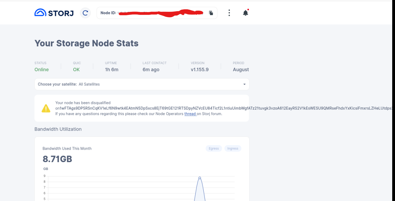

Hello,
as per attached image it seems to be disqualified at least on one satellite. Not sure, can you confirm ?
The node is online but there is not activity, just enqueue notification. Neither a success or progress . Not sure if it’s doing something in the background.
I renamed s0 and s1 in the path /mount_point/storage/hashstore/1wFTAgs9DP5RSnCqKV1eLf6N9wtk4EAtmN5DpSxcs8EjT69tGE/ to fix another issue. AI information, maybe wrong.

I can confirm - your node is totally disqualified. You deleted wrong s0, s1 folders. They have had customers’ data.
Why you ever did this?
Ok, now you can remove this identity and remained data, generate a new identity and start with a clean storage.
Please never delete customers’ data.

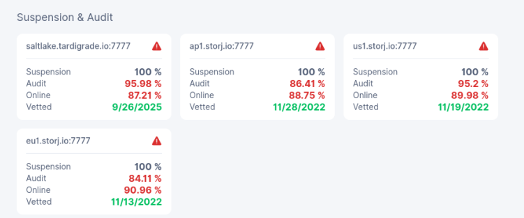

Hi Alexey,
thanks to confirm , I will delete storagenode4 and recreate it.
This is the full picture of all my nodes and I have others disqualified in one satellite but full working (upload and download are comings) :slight_smile:
pi4 - storagenode - healty
hpool - storagenode3 - DISQ 12Eay - running with errors
hpool2 - storagenode7 - heatly - running
hpool3 - storagenode8 - healty - running
hpool4 - storagenode4 - DISQ 1wFTA - blocked tb deleted
hpool6 - storagenode6 - DISQ 1wFTA - running
hpool7 - storagenode2 - DISQ 1wFTA - running
What should I do here (for the one still working on other satellite ?)
gracefull exit and spin up new nodes in parallel ?
leave as is, spin up new nodes and then gracefull exit ?
leave as is and the satellite will be recovered ?
PS I have a major power outage issue that caused my servers to crash 5 times in a few times. Some restart also during fsck. a mess.
Best regards
If the node is not DQ on all satellites yet, you can continue to run it. If it’s DQ on all satellites - delete the identity and its data and start fresh (with generation a new identity for each node, don’t clone, all clones will be DQ almost instantly).
However, I would like to suggest to investigate, why they were DQed. If due to your actions - then please do not do them again.
