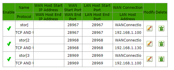

No, the server inside the container still runs on port 28967. You’re forwarding 28968 outside of the container to 28967 inside of the container. Have you doublechecked your port forwards, add exception to firewall etc?
Ports checked, other applications running fine (and other dockers too)
also checked with some tools that this are opened outside the network
