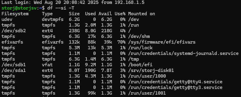

Please show a result of the command:
df --si -T
Also, did you move databases to a different drive?
I did this:
Which happens to be in the O.S. drive.
So, this is a local drive, perhaps USB, and the databases are on the same disk.
So, perhaps you have had database is locked errors, which may result in inability to update the database with the actual stat.
It could recover itself after the next update (when the node will be automatically restarted, and the filewalker will be triggered), or like you did using my suggestion. This database is a cache, so not a big deal to recreate it.

About usb drive I’m not using any, must be a partition created automatically for some reason.
