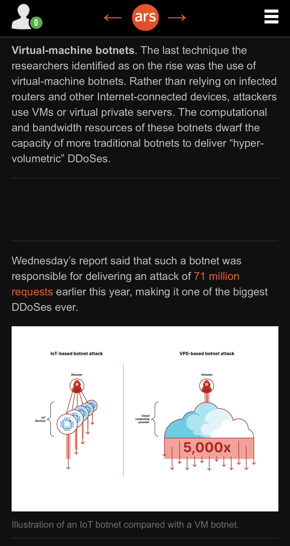

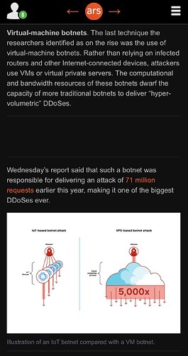

I believe VPS providers will start adding more limits to hosted clients, and disrupt storagenodes. Dosen’t seem a reliable way to run SN anymore…
It was never a good way in the first place, IMHO
