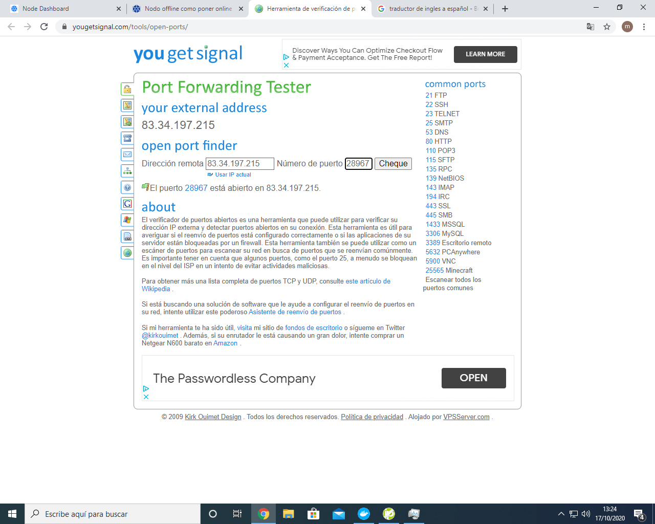

  1. You need to check your WAN IP on the router, please, write it down
  2. Go to the https://www.yougetsignal.com/tools/open-ports/ and compare the WAN IP with IP there, if they do not match - the port forwarding will not work and node will be offline.
  3. Check your port forwarding rule on your router and make sure that it uses the same IP as your PC with storagenode
  4. Check your firewall, it should allow the incoming connections to the TCP 28967 port
everything is correct

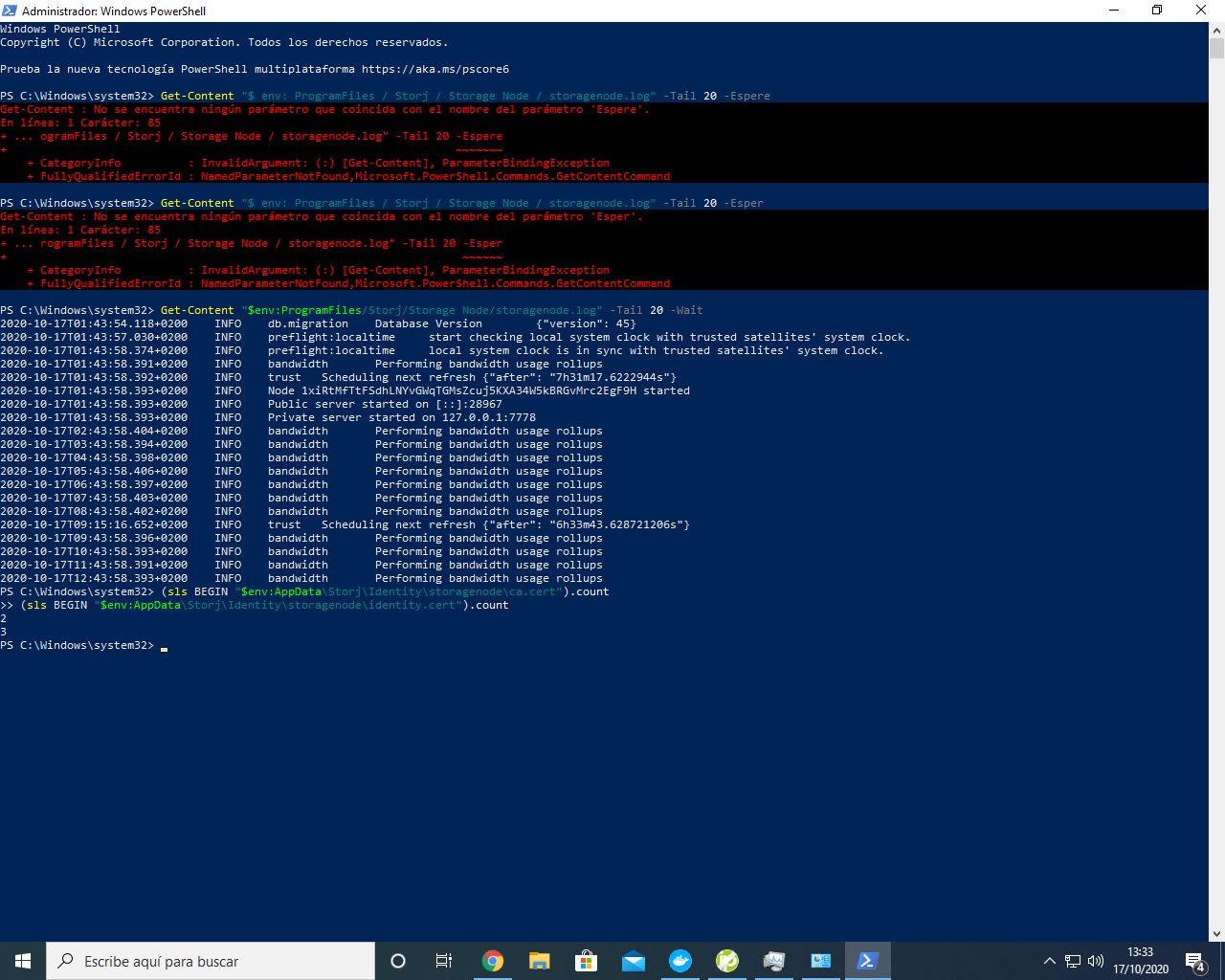

Please, check your identity: https://documentation.storj.io/dependencies/identity#confirm-the-identity
It seems that everything is fine but it is still offline

As you can see, your external address in the config is different from the IP on yougetsignal
So, you public IP is dynamic. Thus you need to use a DDNS hostname instead of IP in the config file
You can use this guide to setup a DDNS: https://documentation.storj.io/dependencies/port-forwarding#setup-dynamic-dns-service-hostname-configuration
