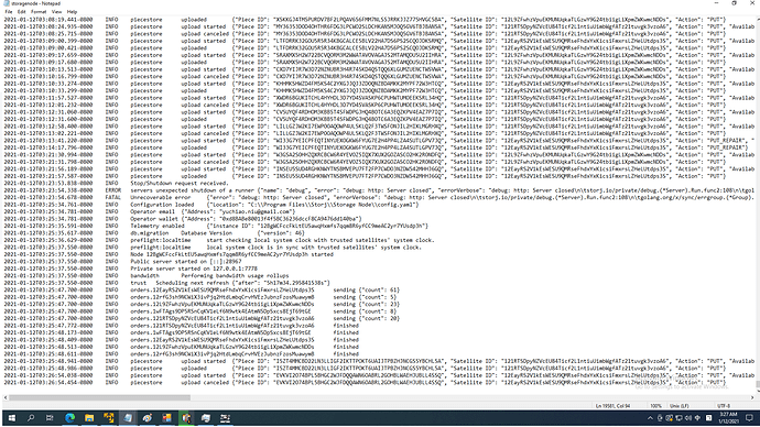

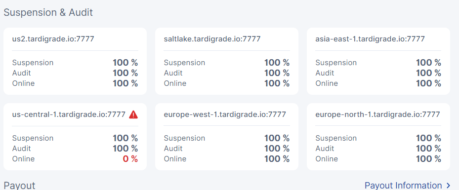

Like this. Today I found one of the satellite is not online. How can I figure this out? Thank you
Check the log file, it should show the reason for failure.
When we’ve seen this with just one satellite before it was an ISP issue where traffic to one region was down.
It could be worth talking to your ISP as it’s unusual for parts of the internet to be inaccessible.

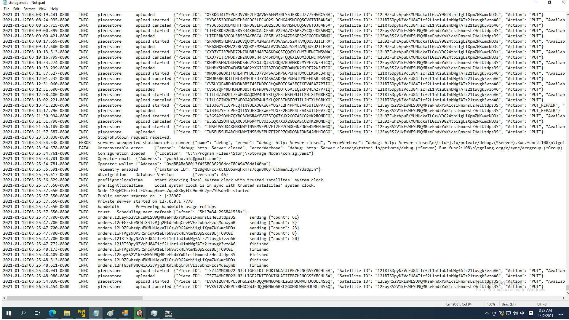

In your log I see entries for the us-central satellite (id 12EayRS2V1kEsWESU9QMRseFhdxYxKicsiFmxrsLZHeLUtdps3S
), so I would just sit tight and the online score should show up soon. This is your recently started node, so it shouldn’t be a problem. The sixth satellite (us2) is new, so it is not surprising that may not be seeing traffic from it yet.
