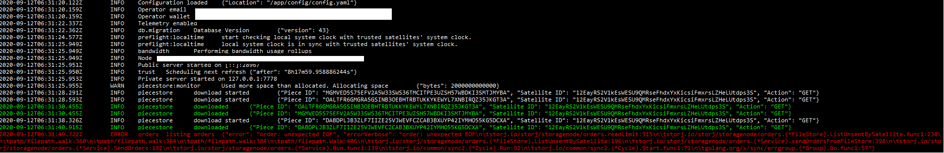

It is not clear to me how to solve this error in the log ![]()
What to do? ![]()
Windows 10 installation
Unfortunately the logs do not provide enough information yet to be able to tell you precisely what to do, but hopefully we can make them clearer in the future. Basically, one or more of your unsent orders files has been corrupted. There is one unsent orders file for every hour, but presumably the corrupted one(s) are before the log you posted above (2020-09-10T11:53:51.382-0300) - maybe you can narrow down which files it could be based on that.
An easier solution might be to move all the files out of the directory (donât delete, just move), then put them back in one at a time or in batches to send them out - the node should be configured to attempt sending every 5 minutes by default, but it can be reconfigured.
By the way, since you have timestamps for the logs and can figure out when you first saw this error, you should be able to make the process a little easier by only messing with files before that point. You can do that by taking the last portion of the unsent file which looks like â1599692400000000000â (representing the timestamp of the order creation hour) and plugging that in here: https://play.golang.org/p/0HBazvcfYPa

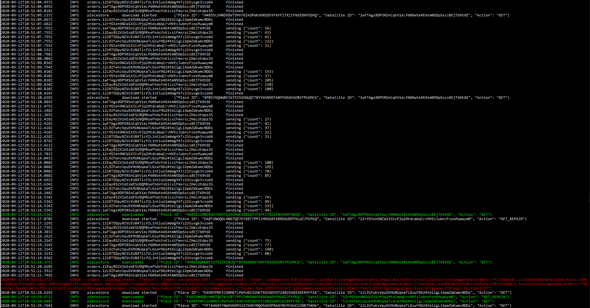

Even after moving all unsent files to another folder. I still get
ERROR orders listing orders {âerrorâ: âorder: unexpected EOFâ, âerrorVerboseâ: âorder: unexpected EOF\n\tstorj.io/storj/storagenode/orders.readLimit:515\n\tstorj.io/storj/storagenode/orders.(*FileStore).ListUnsentBySatellite.func1:238\n\tpath/filepath.walk:360\n\tpath/filepath.walk:384\n\tpath/filepath.walk:384\n\tpath/filepath.Walk:406\n\tstorj.io/storj/storagenode/orders.(*FileStore).ListUnsentBySatellite:196\n\tstorj.io/storj/storagenode/orders.(*Service).sendOrdersFromFileStore:398\n\tstorj.io/storj/storagenode/orders.(*Service).SendOrders:192\n\tstorj.io/storj/storagenode/orders.(*Service).Run.func1:139\n\tstorj.io/common/sync2.(*Cycle).Run:152\n\tstorj.io/common/sync2.(*Cycle).Start.func1:71\n\tgolang.org/x/sync/errgroup.(*Group).Go.func1:57â}
I did stop the node, moved ALL unsent files to another folder then restarted my node but it didnât work.
I am really confused about how that could happen. That code path will only get run when there are order files > 1hr old inside the orders/unsent folder. How long after you restarted did this error occur?
