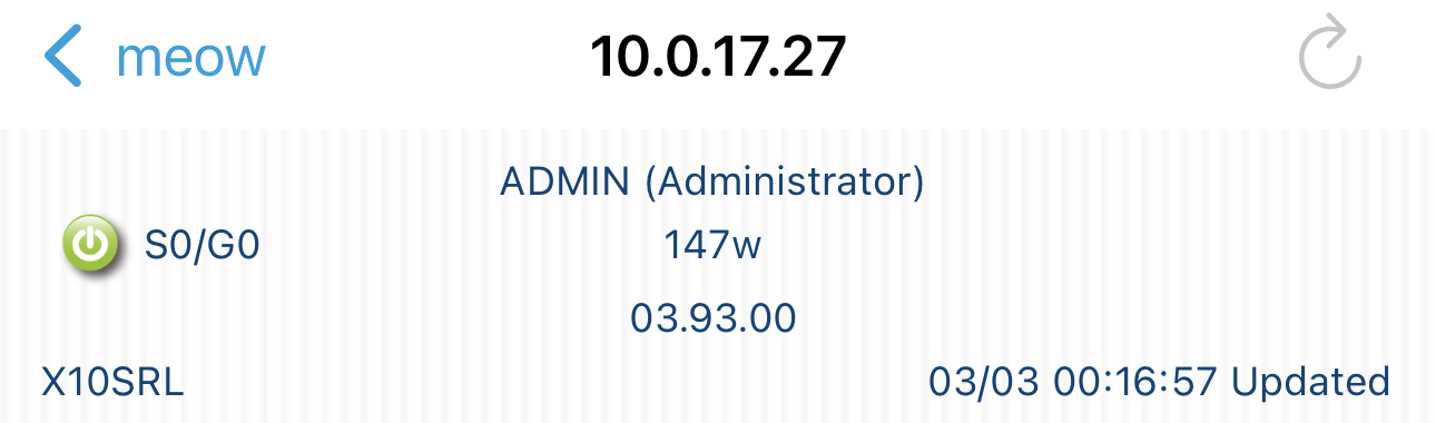

Anyway, now we are at 151W at idle-ish.
Edit. It’s in fact 147 in steady state. Splendid!
