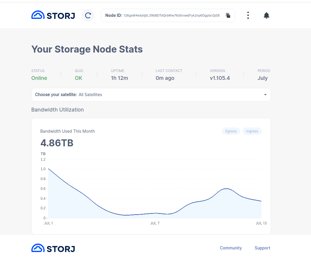

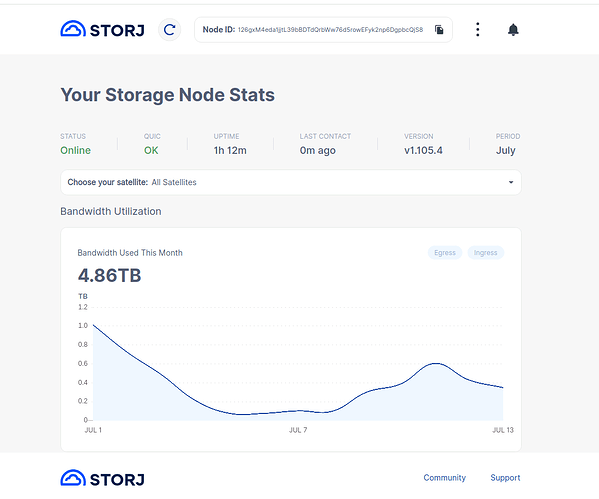

it seems the nodes are on 1.105.4
and not 1.108:
so what i need to do is fix the error with database mix match somehow? and i can do this by updating what exactly?
i see most nodes is on 1.105
but one of them is actually 1.108
no idea how or why

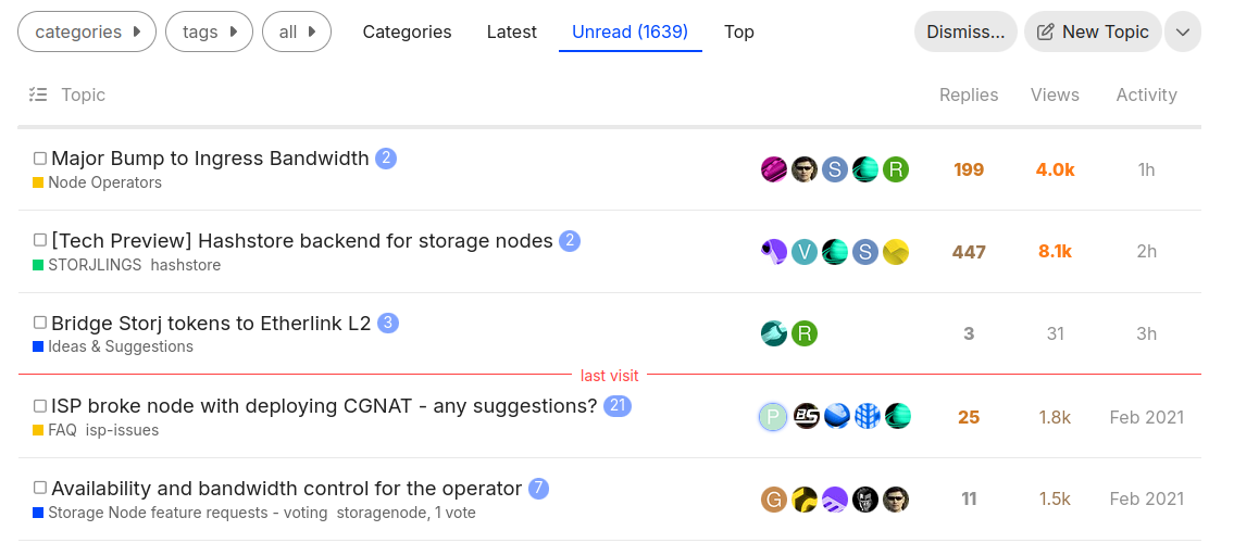

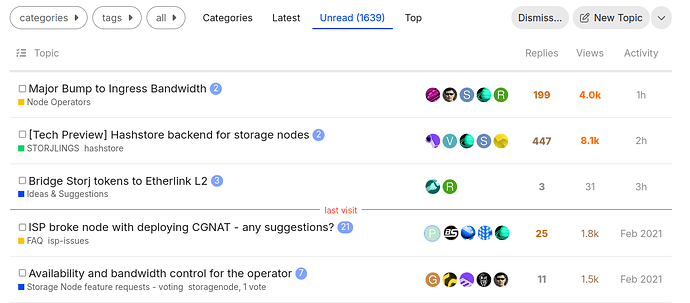

I don’t have this problem, Discourse looks like this for me:
The red line is pretty clear indicator to stop at this point. Maybe it’s a matter of some configuration switches?

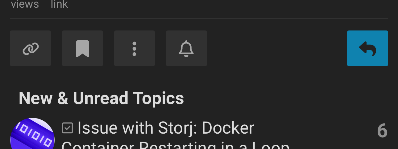

I have this line on the computer as well - but i’m mostly browsing through this forum on my phone, not sure if it’s as visible.
Come to think of it, i believe i clicked on top topics and ended up on this thread. During this - i just didn’t check the date of the latest post. My bad i know :wink:
