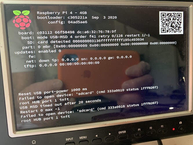

Any advice on how to recover an SD card on my Pi4?
Doesn’t want to boot now for some reason…

What do you see on the screen?

It looks like your pi is set to boot from USB. So if you can get a bootable usb set up, you get the sdcard out.

no defiantly from the SD card
Your sd card is dead there is no recovering less your a master solder and can use a hot blower on the memory and move it to another donor sd card.
E.g. 0xf41
means continuously trying SD card followed by USB mass storage
If you have a backup of your identity or it’s placed on the storage as recommended, then you can just try to flash this card with a latest image, then install docker and mount your drive via /etc/fstab
