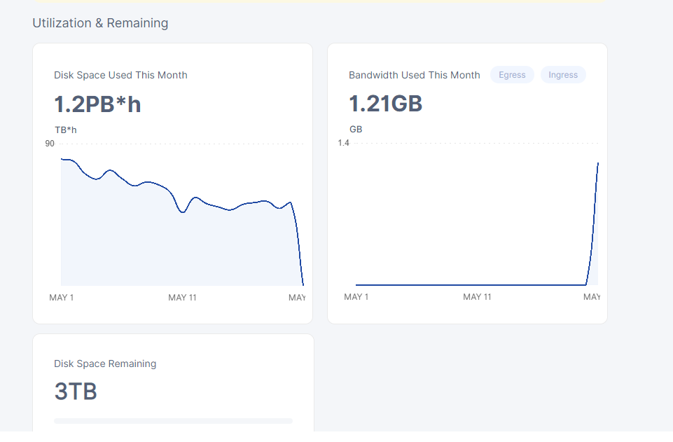

Got an issue : the dashboard statistics resets and the remaining space is false (Shows 99% free instead of 80% full) :

Did you move the existing databases to the new location? It seems like your node just built new databases instead. So either the db’s weren’t moved correctly or the setting wasn’t implemented right and it’s still using the old location, but has created new db’s there.
This is exactly the kind of thing I was warning people about. If you don’t do it right you end with multiple db versions, non of which contain all the data for your node anymore.

Since, I rolled back everything above in reverse but nothing change about the available disk space. Otherwise the node is working perfectly according to the logs except the available space is broken.
The path in the config file points to a path inside the container. Instead you should map the path you want to use for db’s to a path inside the container, like you do for config and identity as well. Then point the config file to that path.
Your node has now created new databases inside the container path. If you have removed the container in the mean time, you’ve already lost the data in those databases, though I don’t think there is a simple way to merge them anyway. Your databases will be missing data and incorrect data will be displayed on the dashboard, api and earnings calculator.
