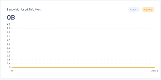

No ingress for this new month so far:

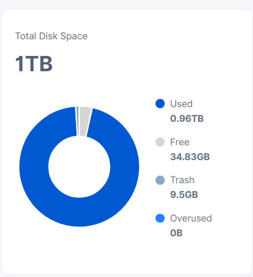

Despite having 2.5TB free space on disk and node dashboard shows
The logs show downloads only.
I have not yet restarted. I believe as soon as I restart uploads would resume.
Its set to 1 TB and the numbers add up, so its normal and no problems at all?
But it says free 34.83 GB? So shouldn’t it receive uploads?
You may receive uploads. What numbers on the MDB?
And do you have “less than requested” in your logs?
No.

Here we go again:
Node dashboard:
dashboard_no_ingress
The node is not suspended, online above 99% on all satellites.
Host has free space also.
What shall I check. Node is getting only egress currently, no uploads in the log.
Still no uploads only downloads.
And still no ingress…

Still nothing:
I have checked the logs. This is the last line with upload in it:
2024-03-30T18:04:04Z	INFO	piecestore	uploaded
After that only download messages. No other messages like errors or something around that time.
Why is there no ingress since then? This seems to be a serious flaw in the code. I cannot check every node every day if it has stopped receiving ingress despite having enough space and being not suspended or something.
