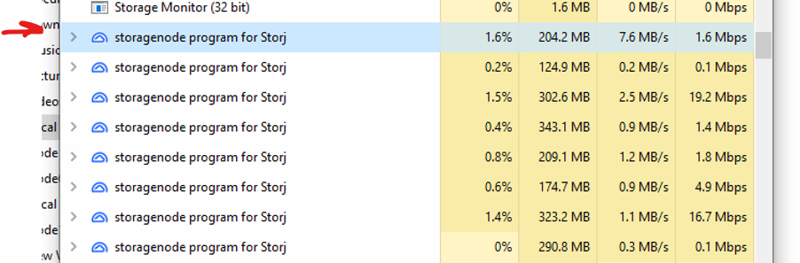

I activated boath, like on my picture, and working looks like only passive
I realy dont understand why it not working, i checked everything

there is a chance, that active converting is just not reporing anything, I tried once more as you suggested, make it UTF-8 and LF end of line.
No logs, but disk activity is 2x or even 3x
Maybe your logs are still not on info
