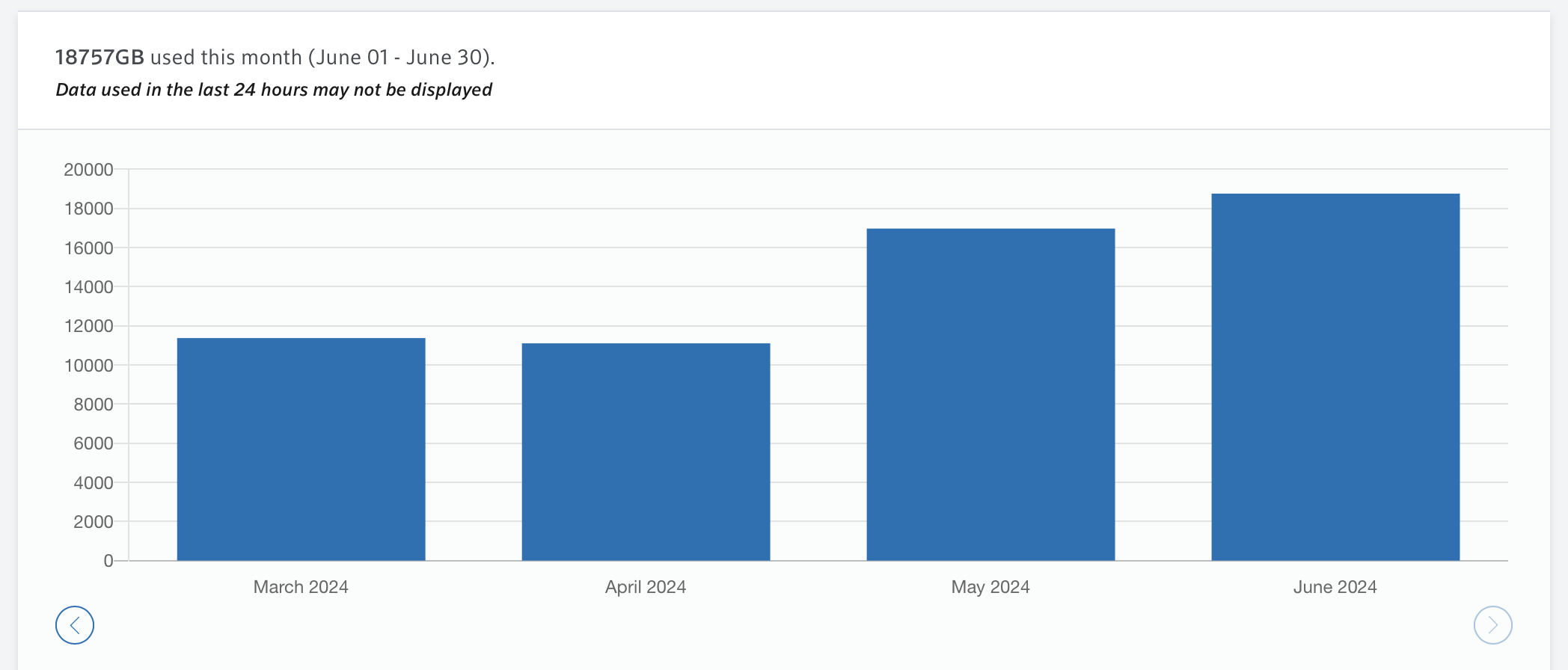

Sharing my unlimited experience from Arizona, USA using Cox cable internet. I have 1000Mbps down and 100Mbps up which was recently upgraded from 35Mbps up which is insanely asymmetrical. I also have the unlimited upgrade as normally you get a fee after 1.25TB for your monthly cycle. I’ve been using 3-4TB per cycle for over a year with it recently going up due to the new ingress traffic. I’ve had no issues.
I work from home and would be above the limit even excluding my 4 storage nodes. QOS via my edgerouterX has been most helpful making sure I don’t turn into a potato on video conferences when working hard to support partners and customers.

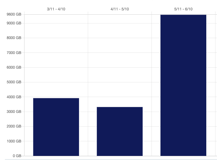

Same. Node traffic does not make much difference:

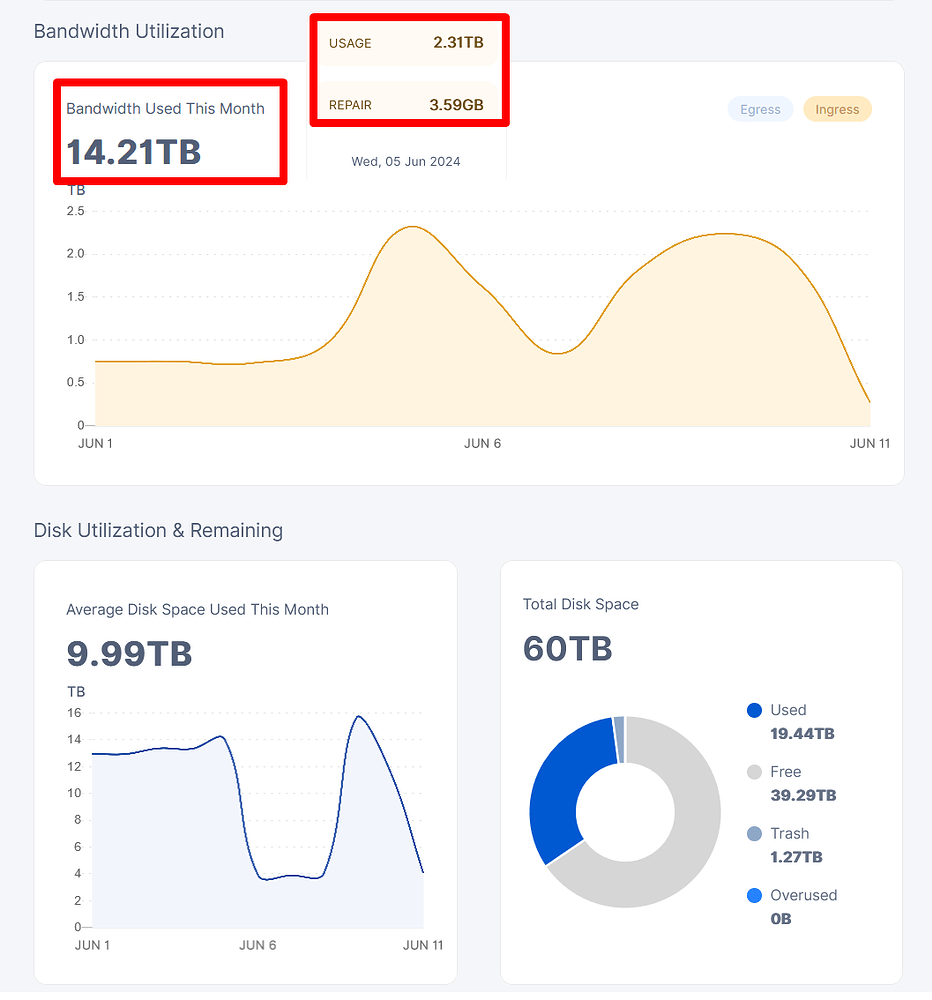

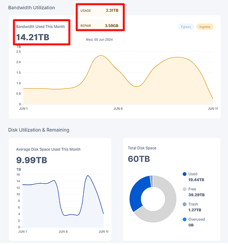

I don’t know what’s going on at my place, something is fishy. I have about 6 nodes running behind one IP address. My nodes don’t seem to go above an aggregate of about 300Mbps and latency really gets quite high. Also, it kills my upstream bandwidth.
