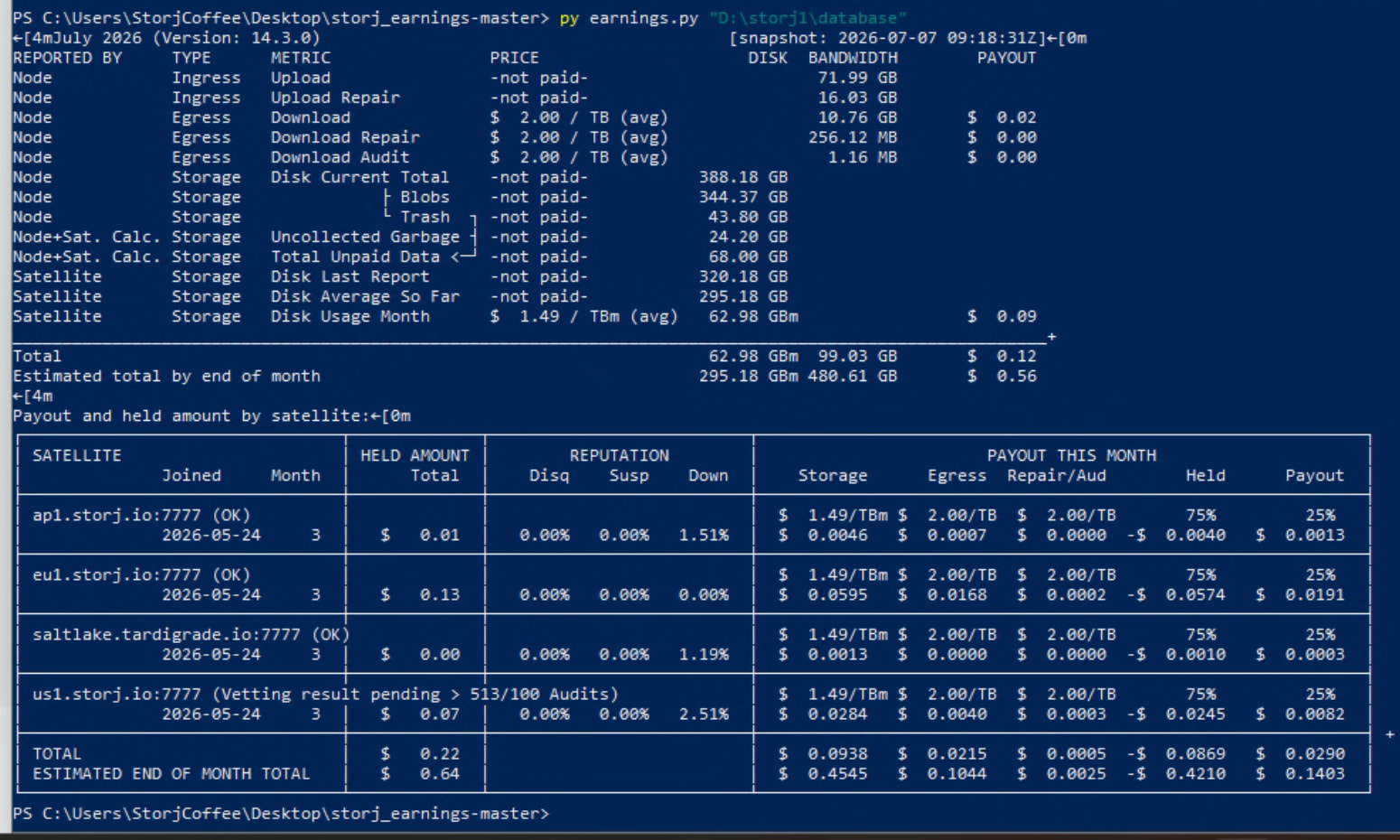

Hello - i have a recently new rig with multiple nodes.
All nodes are over 1 month old. All nodes have completed the vetting status.
Yet for days - over a week, all US vetting status has been:
us1.storj.io:7777 (Vetting result pending > 513/100 Audits)
I dont see why? atleast to my knowledge the nodes live up to the requirement for vetting. (over 1 month old, and 100 audits) - this is not a single case - its ALL nodes.
Anyone know something i dont?
Thanks in advance! :slight_smile:
