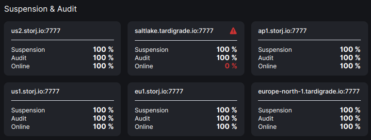

Your node has been disqualified saltlake.tardigrade.io:7777
Sir, it showes 0% online at saltlake. look it up. the next post.
Your link doesn’t work, please post a screenshot here instead.
Does it still 0%?
And what is your errors for this satellite and ā€œping satellite failedā€ but ā€œratelimitā€?
This linkk works to me still (the node got up to 100% online us1 satelite but 0% on saltlake satelite - Album on Imgur)

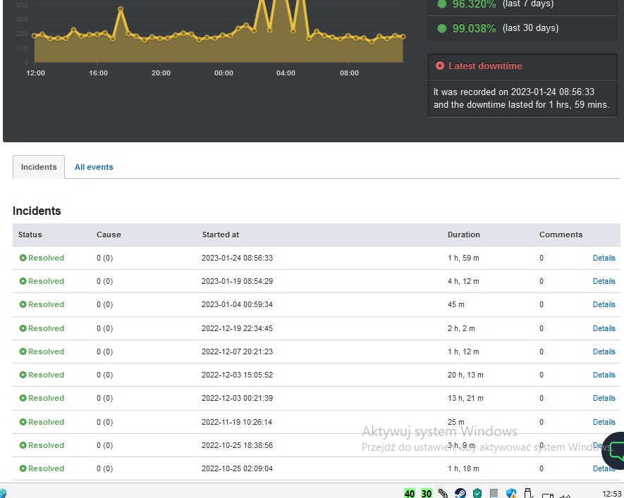

uptimerobot:

Yes its still 0% on saltlake, its been Disqualified on 24.01.2023 its says in the dashboard.
Node ver is 1.70.2
(i have 1,20$ payout from saltlake for december yet)
If it’s disqualified, then none of scores will recover. To be disqualified for downtime your node should be not available to this satellite more than 30 days.

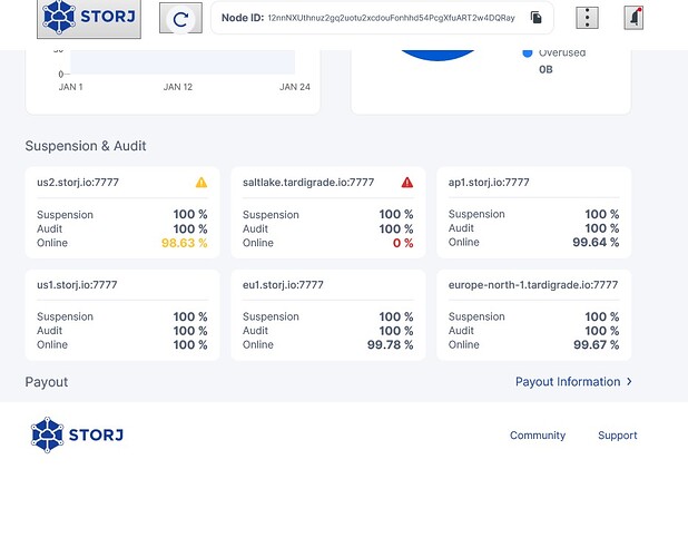

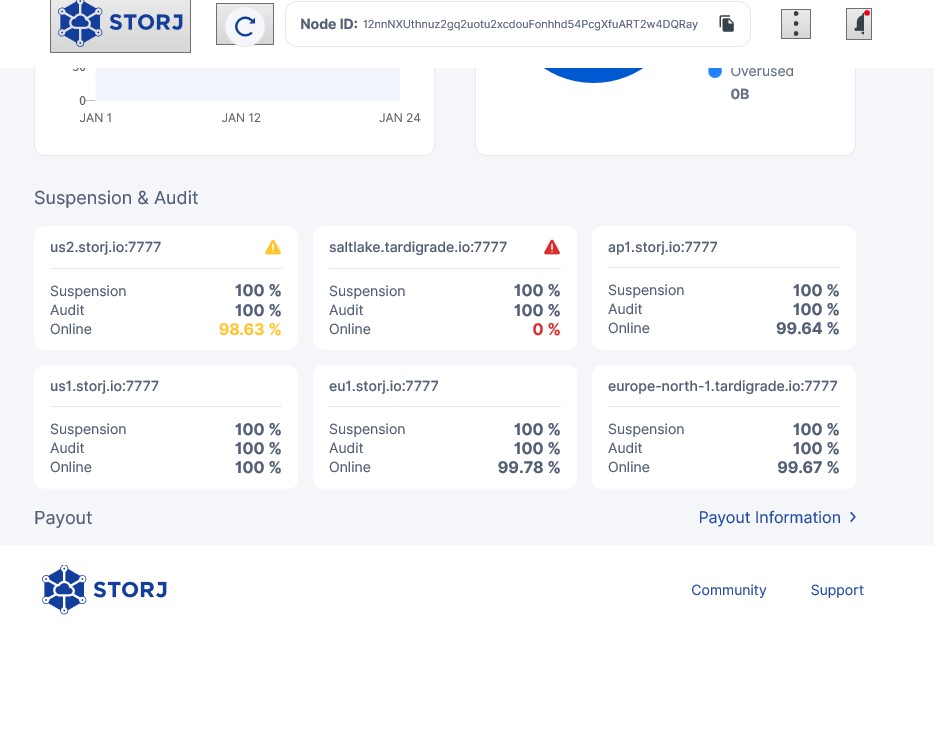

Hi,
I have the same problem as Ruskiem, and only saltlake.tardigrade.io:7777 is offline, while all other servers are 100% online.
The DNS error is concerning an internal address 10.103.0.10 and 10.101.1.12. I don’t have this kind of IP address.
Is it possible that the problem is coming from the saltlake.tardigrade.io:7777 server ?
Here is the error in the log is:
2023-01-29T19:12:16.837Z ERROR contact:service ping satellite failed {ā€œSatellite IDā€: ā€œ1wFTAgs9DP5RSnCqKV1eLf6N9wtk4EAtmN5DpSxcs8EjT69tGEā€, ā€œattemptsā€: 11, ā€œerrorā€: ā€œping satellite: check-in network: failed to resolve IP from address: nyrl.myz.info:28967, err: lookup nyrl.myz.info on 10.103.0.10:53: read udp 10.101.1.12:55027->10.103.0.10:53: i/o timeoutā€, ā€œerrorVerboseā€: ā€œping satellite: check-in network: failed to resolve IP from address: nyrl.myz.info:28967, err: lookup nyrl.myz.info on 10.103.0.10:53: read udp 10.101.1.12:55027->10.103.0.10:53: i/o timeout\n\tstorj.io/storj/storagenode/contact.(*Service).pingSatelliteOnce:136\n\tstorj.io/storj/storagenode/contact.(*Service).pingSatellite:98\n\tstorj.io/storj/storagenode/contact.(*Chore).updateCycles.func1:87\n\tstorj.io/common/sync2.(*Cycle).Run:152\n\tstorj.io/common/sync2.(*Cycle).Start.func1:71\n\tgolang.org/x/sync/errgroup.(*Group).Go.func1:57ā€}
This message from the satellite, so these private IPs belongs to the satellite and it’s unable to reliable resolve your DNS hostname every time (in this case seems - never).

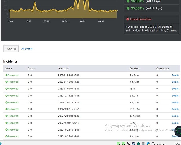

My Online for saltlike continues to be in the red. It has in fact gone down from approximately 88.97% to it’s current value of 88.67%. I’ve been monitoring it using the UptimeRobot and over that time there has been ZERO (0) reported interruptions. So why is it going down. As I’ve stated as well in my initial post there has been ZERO (0) interruptions, however, there was no way for me to prove it. Now I have this UptimeRobot that says the same. What is going on with saltlike because I do not believe it has anything to do with my node?
