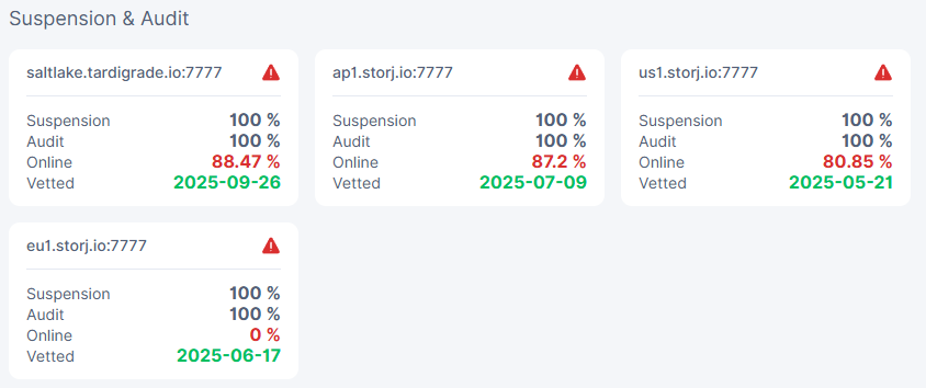

I also had a node DQ’d from the European satellite this morning… however it was only offline for around 2 days and the other satellites show closer to 90% uptime (even after the recent continuous drops).
I think something else may be going on.

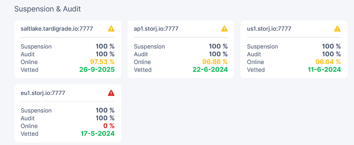

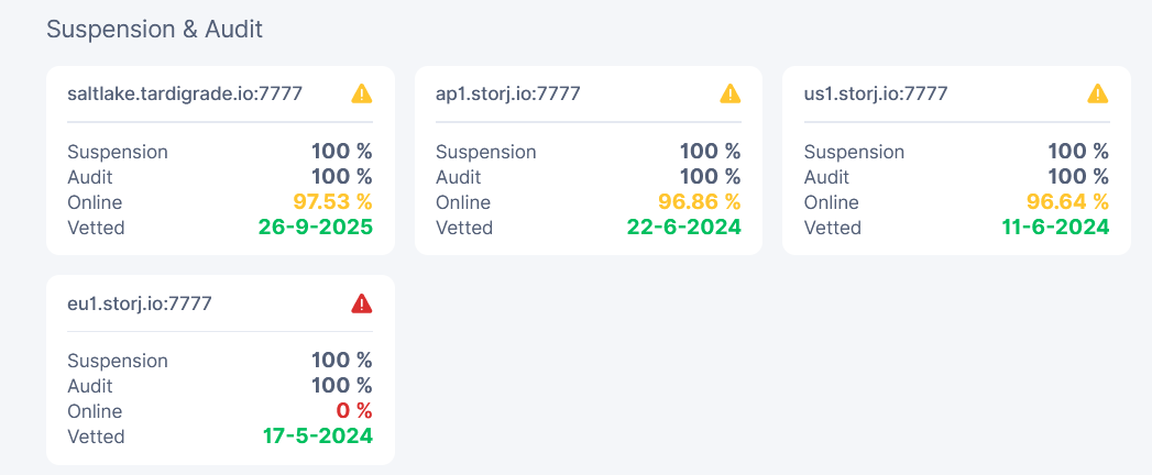

What’s still frustrating is that the dashboard never gave me any signal to investigate further. And ironically, it’s doing the opposite now: 12 hours after fixing the actual connectivity issue, the online score suddenly dropped from 99% straight to 0%, instead of recovering. That really does look like a bug in the scoring/reporting logic rather than an accurate reflection of node health.
Just guessing, but I suppose, that node cannot speak to satteliteno new information about online scorelast score preserved, node has no way to find that online score changed.
It would be most probably possible to indicate, that last connect to satellite failed, last successfull connect to satellite time and so on, but if it’s worth the effert - hard to say.
