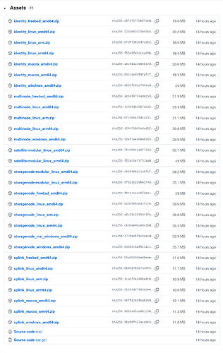

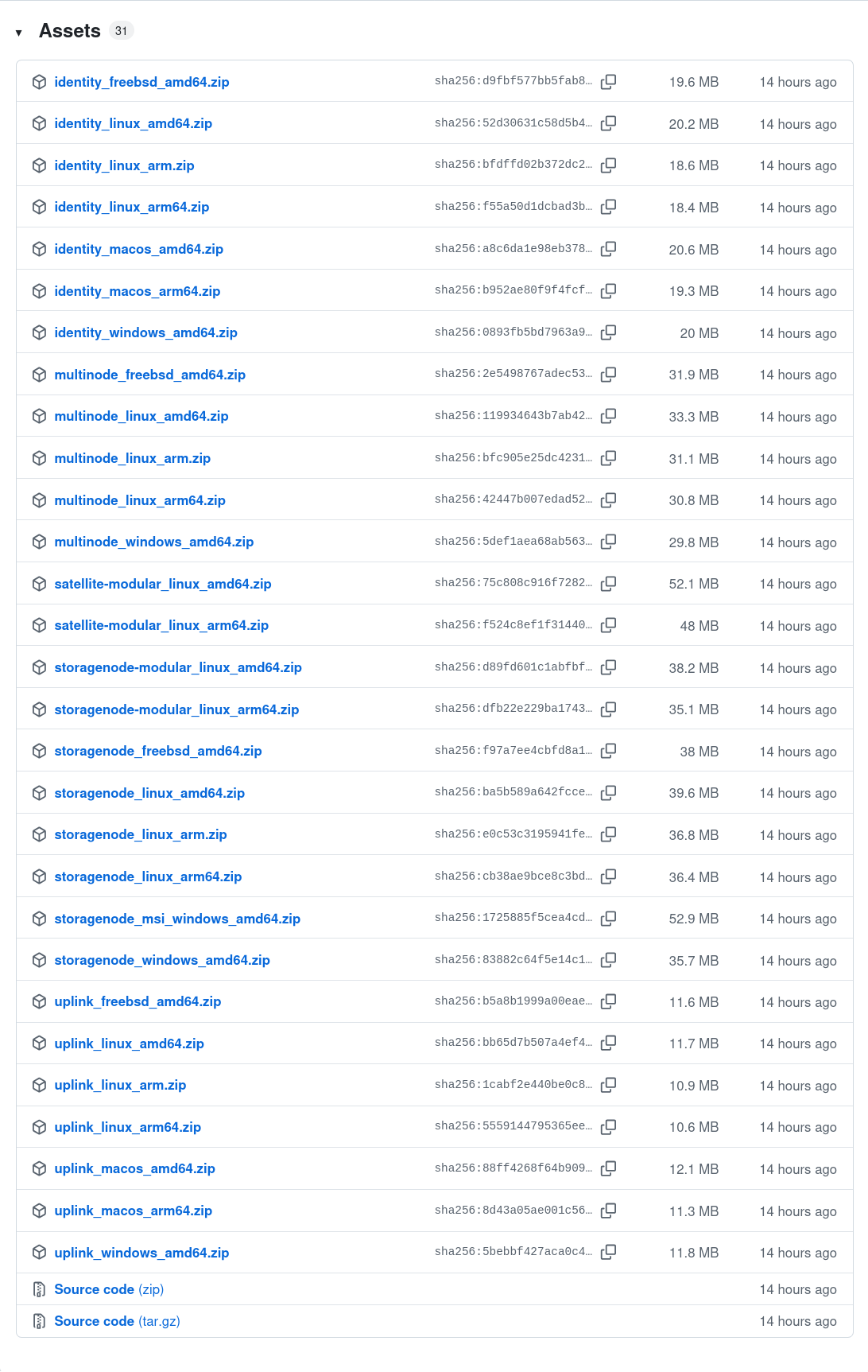

v1.155.8 was published on June 11, 2026 at 18:41:53 UTC
So it should be available since then, maybe it’s not updated on your closest CDN?
But storagenode-updater_linux_amd64.zip is not in this release.

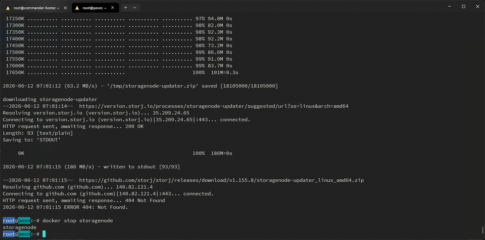

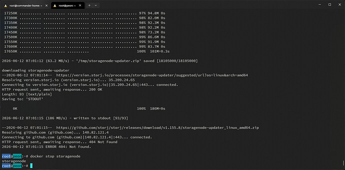

Good question, I saw the error from the image logs:
When I attempted to download the same URL on different machine, unfortunately, I got same error message. Next I start looking for the URL and got same, like @mr.Viking:
So, maybe some glitch in GitHub pipelines? (to updater goes wrong version, which was deleted or not existed in the time, I am not sure).
