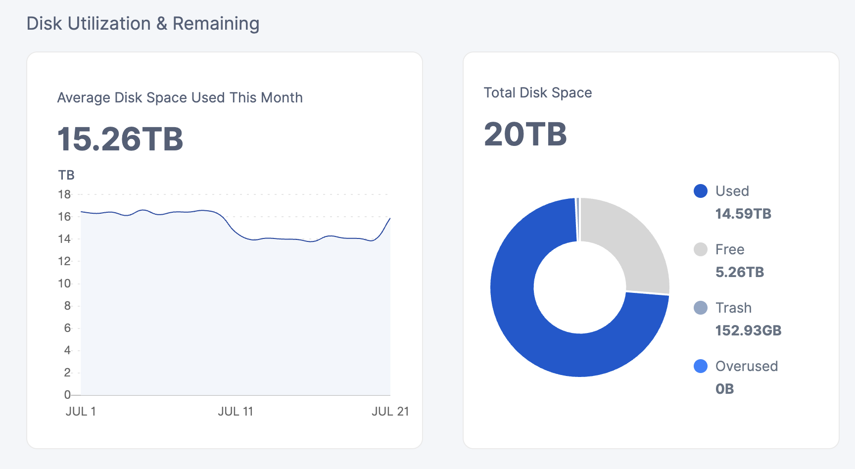

My 1.08TB has just moved from Trash to Free :slight_smile:
Yeah same here.
And took quite some CPU on my Synology :slight_smile:
Obviously:
But glad it worked out and ran through nicely.
