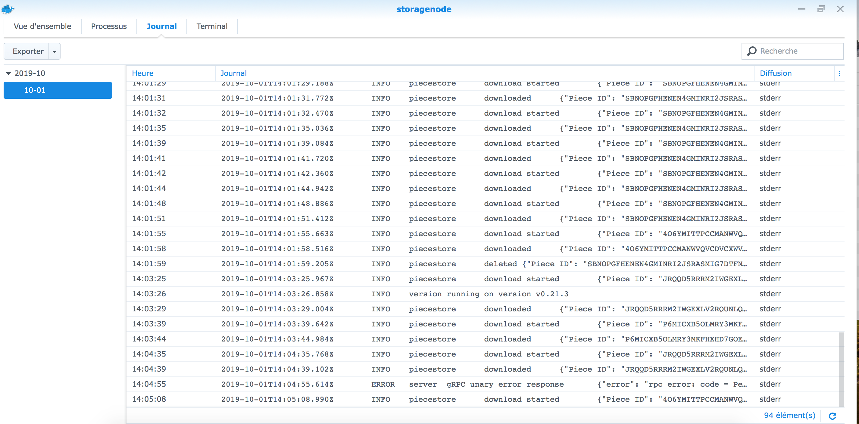

2019-10-01T13:39:26.830Z ERROR nodestats:cache Get disk space usage query failed {"error": "node stats service error: rpc error: code = PermissionDenied desc = node not found:
2019-10-01T13:39:26.830Z ERROR nodestats:cache Get disk space usage query failed {“error”: "node stats service error: rpc error: code = PermissionDenied desc = node not found:
Hello @graphtek, This is a temporary message caused by the fact that your node is new enough that not all the satellites know that your node exists. This message should disappear with time. Just keep your node online. If you want to know more in depth explanation of errors go here Error Codes
Can you explain the issue you are facing rather than posting just the error messages ? From what I remember you are an old SNO. Is this your new node ?
According to the stats in storjnet.info, it appears to be a new node explaining the node not found.
Yes exactly this is a new node and the problem is fixed. thank you for your explanations. sorry not to have been clear in the explanation of my problem.
