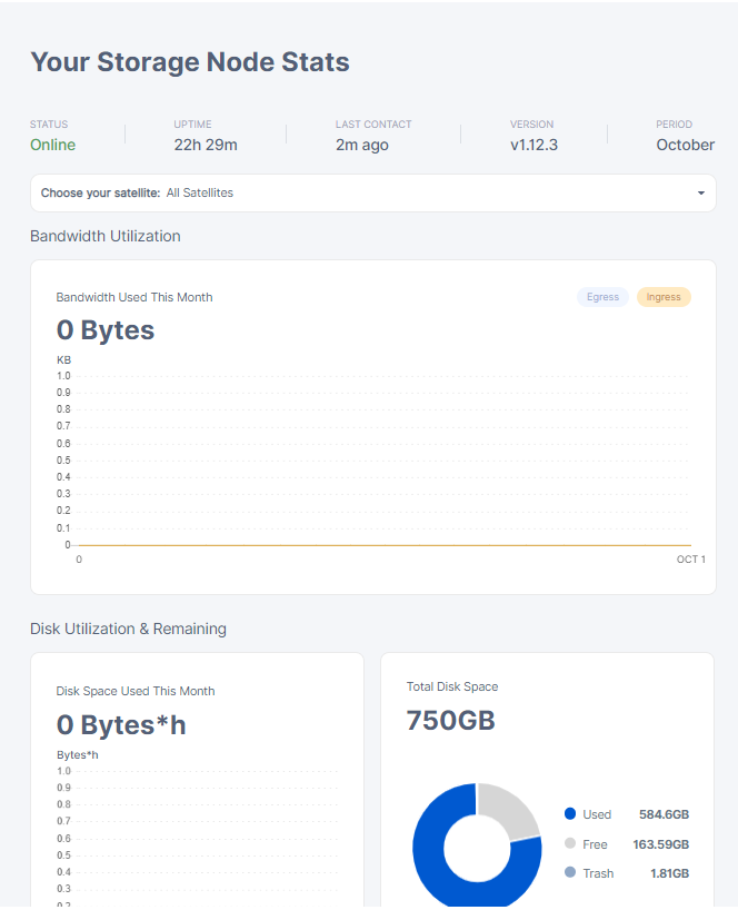

Could you send a screenshot of your dashbaord?
Ive got free space and the node is online.

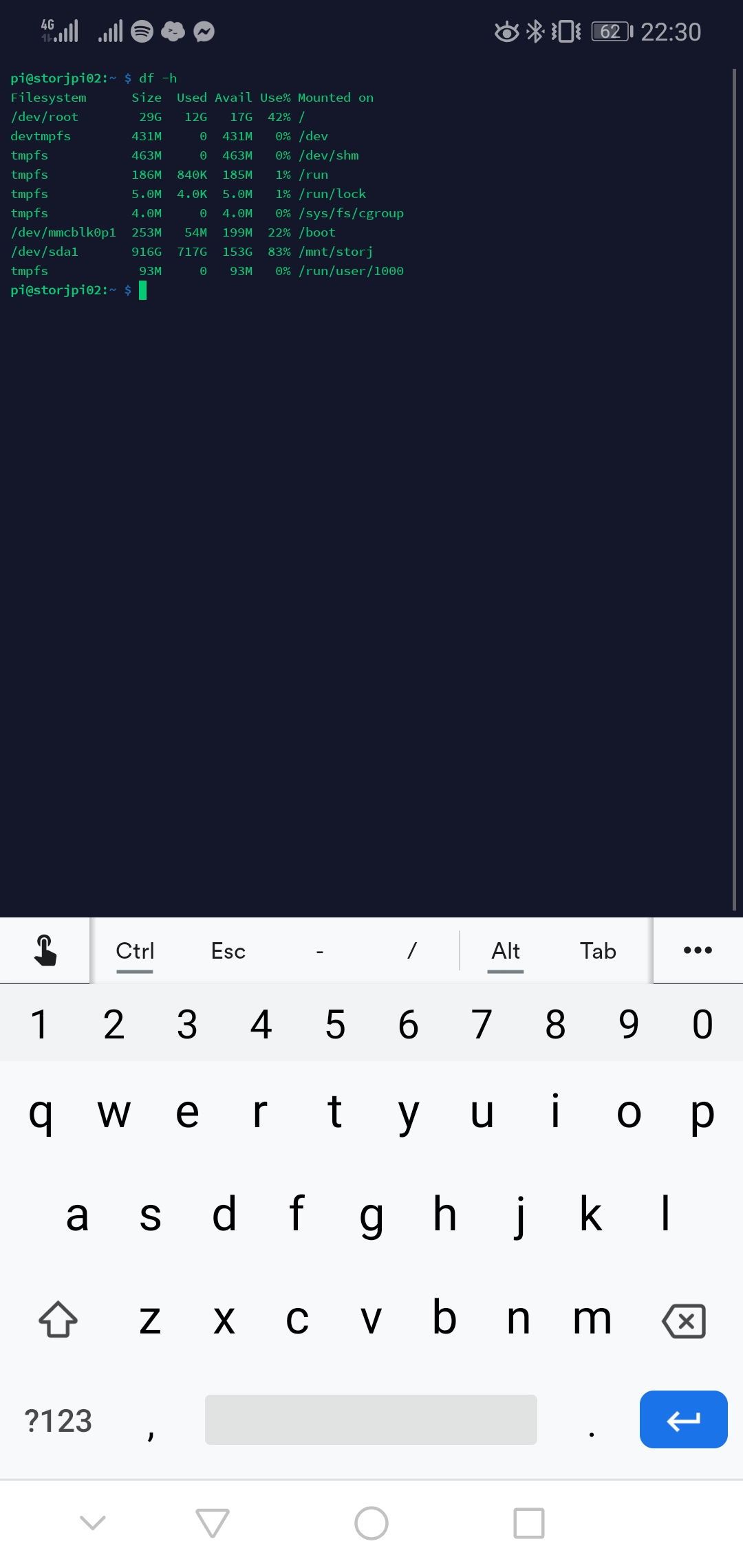

If you are on Linux, could you give the result of “df -h” command?
How old is your node?
Its a 3 months old node on a pi3.
Still no ingress at all?
Could you check the CLI dashboard and send the results?
