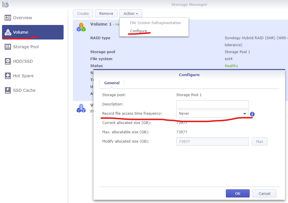

You can find it in storage manager:

I never record access time of files.

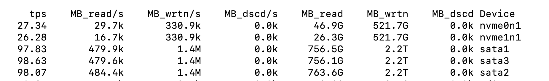

This is why I’m only caching the Storj DBs. The amount of cache is more than enough (never gets full) and yet, with an uptime of 19 days I have this result:
It writes half a Tera and reads 50GB…

I could do that. Access time is a volume thing, it’s already disabled. The only thing I can gain is the checksumming (constant payload, not what wakes up everyday at midnight). What I really wanted was another volume.
