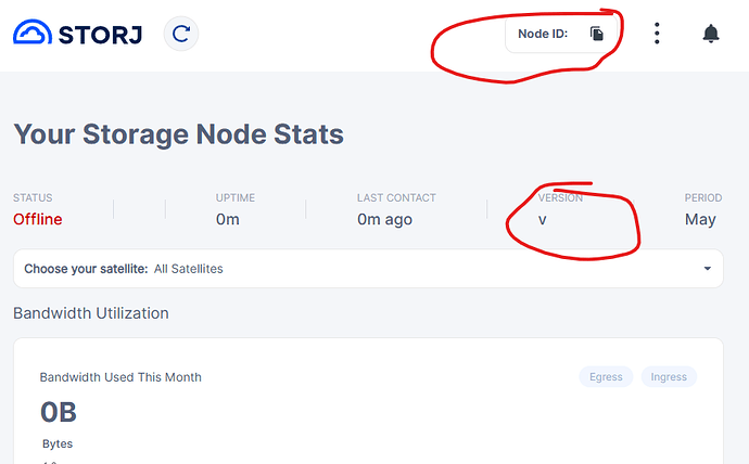

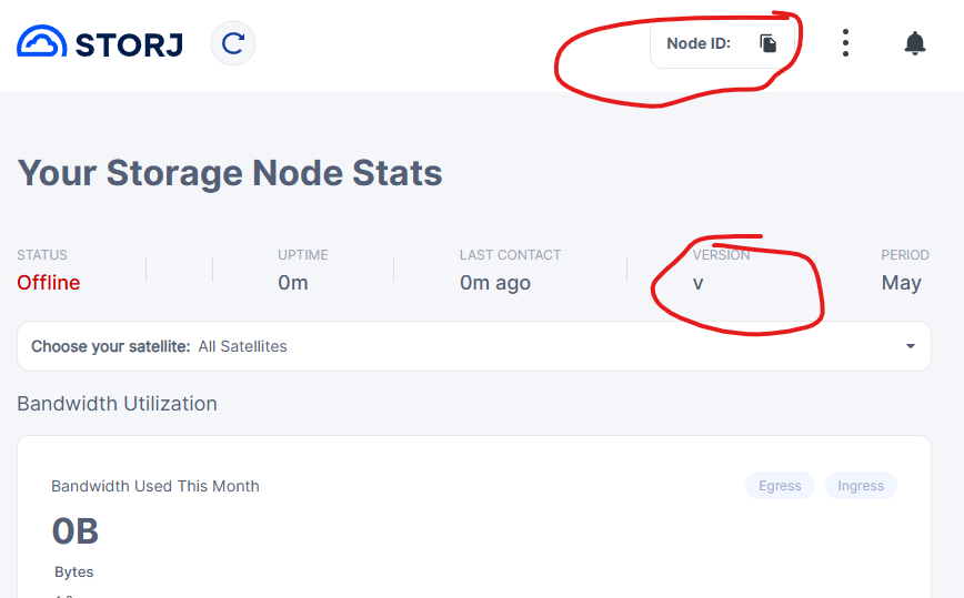

After Windows server reboot dashboard zeroed but traffic exist

But how it related to the totally local information - dashboard working and display at least Node ID and version ???

All things about traffic/DNS/SNAT not affect version and Node ID . Where is it ? While dashboard doesn’t working all another thing in this case doesn’t matter ))
Yes, this does look like something gets stuck and node fails to fully initialize. Maybe databases are screwed up. Try following the documentation to rebuild the databases. If that was an issue — and assuming windows host, very likely it is indeed — it may progress forward enough to log next issue.
I would also run chkdsk on the disk to fix any other possible filesystem corruption, I doubt the damage is limited just to databases.
This is indication of the fact that the node, which you trying to connect, is stopped or restarting. The dashboard would look like this on the cached data, but without a connected node. You can do Ctrl-F5 and it will likely show you a page to check your connecting address.
So, please listen @arrogantrabbit he suggesting right things - please fix the restarting problem first. You may search for FATAL and/or Unrecoverable errors, i.e. in PowerShell:
