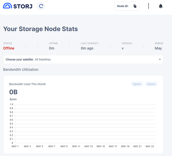

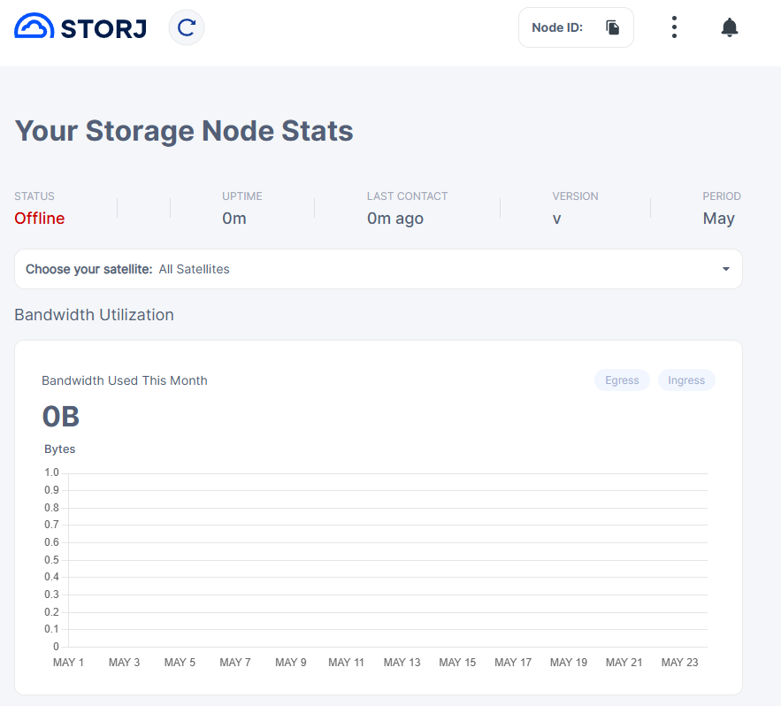

After Windows server reboot dashboard zeroed but traffic exist
After Windows server reboot dashboard zeroed but traffic exist. Connection status OFFLINE but log shows activity

You may try to clear the cache and force reload a dashboard in your browser.
If the status wouldn’t change, then please search for “ping satellite failed” in your logs, e.g. in PowerShell:
sls "ping satellite failed" "C:\Program Files\Storj\Storage Node\storagenode.log" | Select -last 20
To reduce a log file, you may stop the node, rename the file and restart the node.

I’m still have Dashboard in a this state
Storj traffic active
Looks like your node is online and accepting traffic

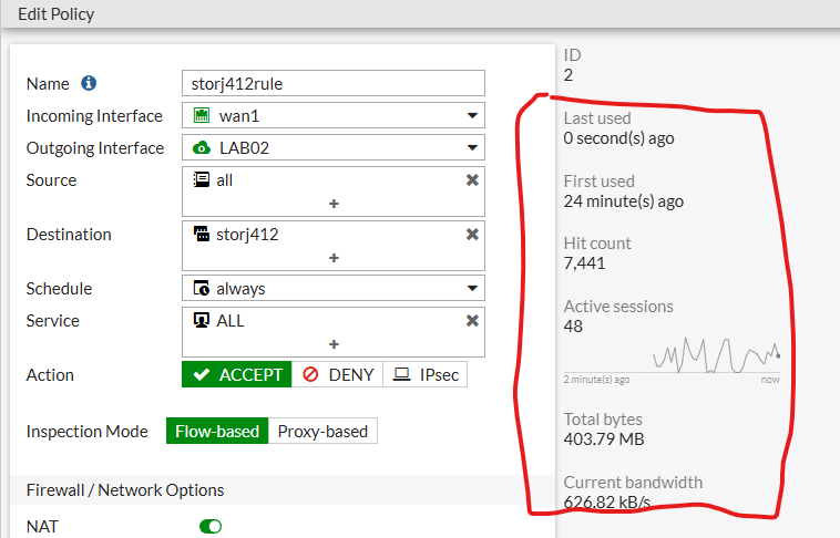

However all IPs it interacts with are 192.168.113.1. Yiu have masquerading configured incorrectly.

It’s either stale web page (refresh from origin) or it gets confused because your NAT is messed up.
I would focus on fixing networking. You want to see actual addresses in the log and. Of those of your translator host.
Your FortiGate inbound port-forward/DNAT rule is also doing source NAT, so the Storj node sees the firewall interface address 192.168.113.1 instead of the real remote peer
Before last reboot all was right - even with mascraded IP’s after NAT. It’s not a reason - I’ve cheked olg logs and anything with transfers looks the same
The fact that it worked sometimes does not make it right. Your firewall rule is still wrong. Whether this can cause intermittent failures with online status detection or other issues I don’t know, and don’t care to find out. There is no reason to ignore known broken configuration.

(And by the way I would replace fortigate with better firewall. The fact that it allowed to silently mess up the configuration like that (it enabled SNAT without you asking) is disqualifying enough.)

You need to fix the inbound SNAT. The fact that a broken configuration appeared to work for some time does not make it correct, and it does not make it irrelevant to an offline-dashboard problem.
