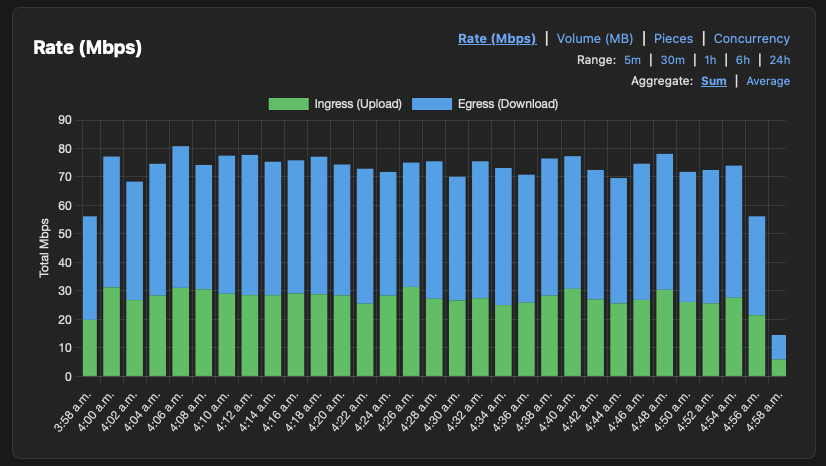

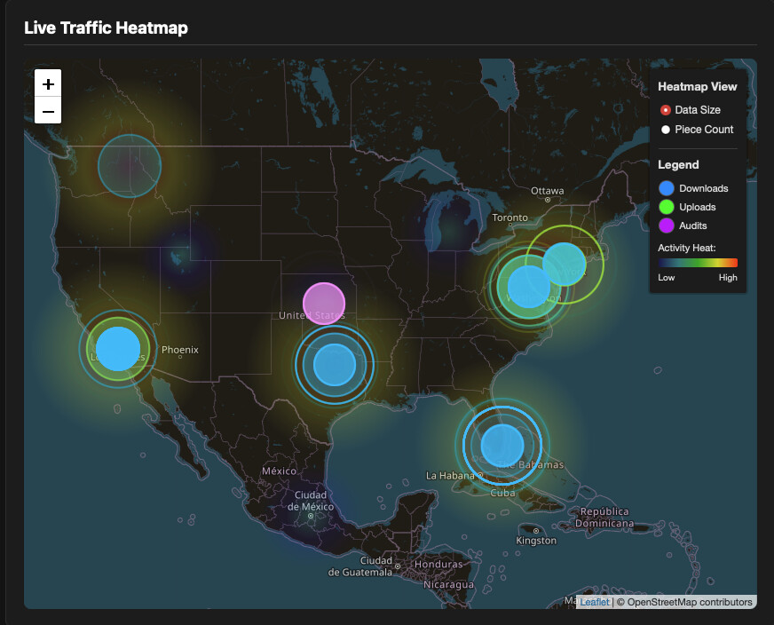

Small heat map update (using Anthropic Opus. Sonnet and Gemini could not figure things out and got stuck in a loop. Total cost - $9.40)
eyecandy
The events appear at the scren at teh cadence matchign actual timestamp of log entries!

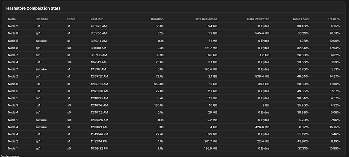

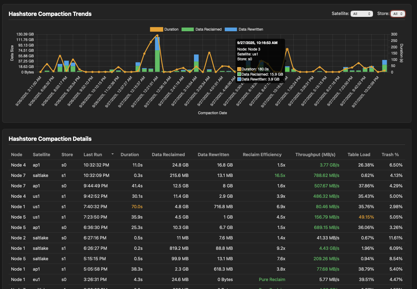

  • Add Hashstore stats
  • Make plots more persistent on server restarts and page reloads
  • Fix map dragging

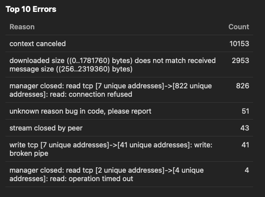

  • Improve error reporting (by agregating errors that only differ by data – such as IP addresses or sizes)
You might need to “Reload the page from Origin” to update the browser cache for this to work. Enjoy :slight_smile:
Hashstore Stats
Better error grouping

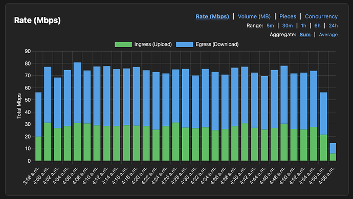

Better traffic plot

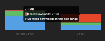

The data on the dashboard led me to an interesting insight: on large pieces (over 1MB in size) my sucess rate is absolutely horrific on all nodes except one. Which one? The one on the gigabit symmetric line (Node 4 on my link above). The other nodes are connected via cable internet with 35Mbps upstrem bandwidth. Evidently, this matters.
The fact that for smaller transfers success rate is fine across all nodes indicats the problem is not latency, but throughput. Again, maybe success rate is lying more on small pieces, and its equally horrendoues, I don’t know. Either way, nothing I can do about it.
Yep. I’m looking at success rates for small and large pieces separately from time to time. In my case I’m usually losing small piece races, potentially suggesting I’m rather far from usual customers; can’t really do much with this. But large pieces go pretty well.
@arrogantrabbit Just fired up the “Storagenode Pro Monitor” on one of my hosts with a few nodes - great work!! It’s very useful and good and creative thinking on the types of statistics.
A few thoughts on new features:
  • Sorting in the lists (especially the HS Compaction stats for node name AND time consumed, but preferably all headers)

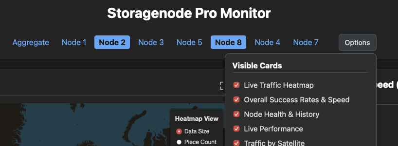

  • Multiselect for which nodes to view data for
  • Possibility to hide / collapse the different sections
  • Popup info on traffic section, text is black on dark background in my browser)
  • Traffic section, when viewing size, could be nicer with GB TB etc. Perhaps overlay on the graphs?
..if you really want to go all in..
History on the hashstore compactions with some graphs for development in runtimes and sizes? Maybe with multiselect on s0/s1 for each sat?

Hashstore table improvement was already on my list, I was waiting for some data to get collected first to get an idea what we are looking at and what can we possibly want to see. The rest — great ideas. Will get them done shortly.

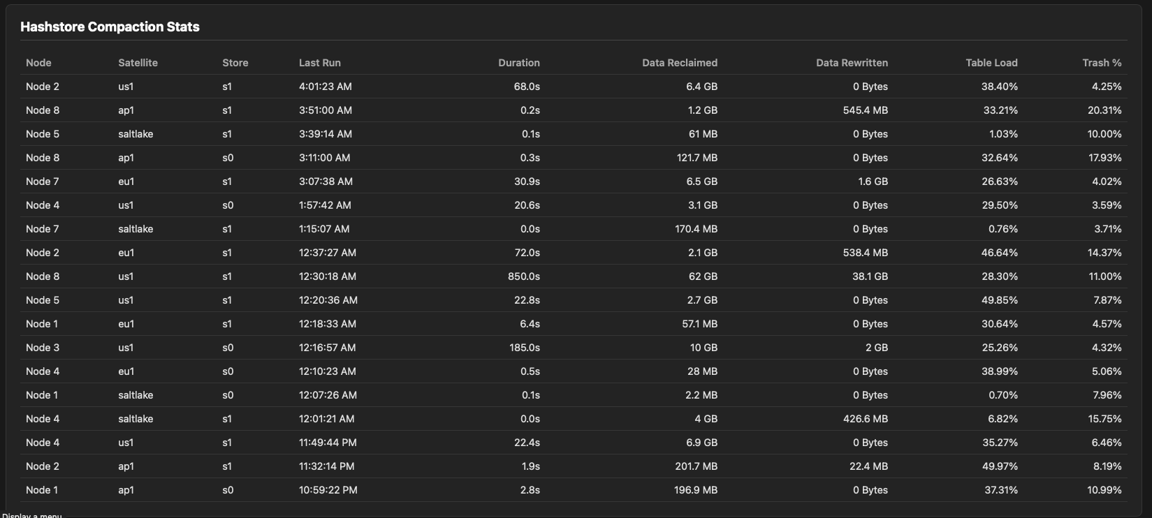

compaction
Nodes and visibility

Realized the timestamp resolution in the log file is 1s, so the animation was naturally clamped to 1s cadence. Ugly.
Now the monitor recovers timing from the actual log entry arrival time.
This of course does not work if the log file is on a network filesystem. For such case there is now an option to use log forwarder.
Animation is now smooth and accurate :heart_eyes:
