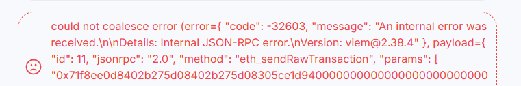

I get this error at zksync portal after I sign the transfer in the metamask/ledger for few days trying to bridge storj from ZkSync Era to different ETH addresses. I have enough ETH on Era and L1 wallet to pay the fees.

It looks like a problem with Metamask, you need to update it to the latest version and probably clear its cache. The Google AI thinks, that it might help.
See also How to fix 'Internal JSON-RPC error' on networks in MetaMask | MetaMask Help Center
Thank you gentlemen. Clearing Metamask did not help, but it went all well with signing through different (Rabby) wallet!
I am wondering what did break the Metamask plugin, maybe when I tried to bridge storj to my deposit Binance address is in unknown state to me now, who knows..
Or a Metamask’s node is behind the network. Since you used your own address to send tokens to Binance, I guess you can prove it for them and they should add tokens to your balance. Because if they sent them back, the bridge contract unlikely can support this and they could be lost.

This confirms that the default Metamask node might have issues and you need to try to clear stuck transactions or switch to use other RPC provider like suggested by AI.
I had the same issue recently. Turned out to be outdated ZKSync Era configuration in my metamask wallet. I have deleted ZKSync era from metamask and added it again using new information from their documentation ZKsync Era RPC - ZKsync Docs
I had outdated RPC URL information.
After the change transaction bridged with no issues.
thanks confirm this work for me
